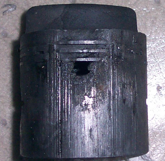

And it was NOT necessary! I've run triples for years without that nonsense and never had a problem. By contrast, of the 12 plus triples to pass through my shop, only one didn't have a burnt top piston.
Here's a photo of the latest one. I was able to save the block, but the rod was scrap.
Jeff
