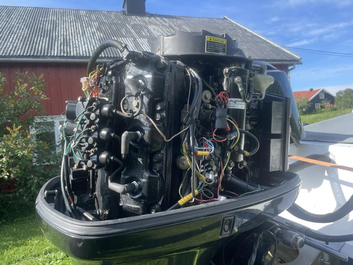

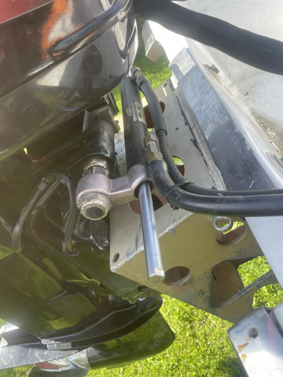

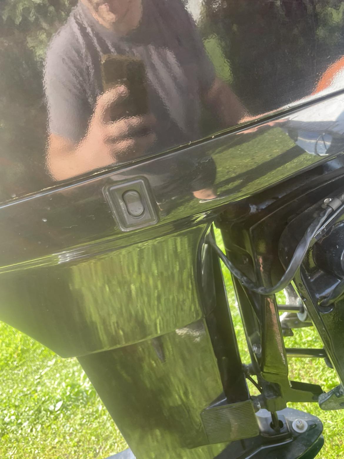

Hello! first of all i need to try to find out model and year on my outboard since i cant find the serial number. i will post this in model/year forum too.
I need to now the aprox model so i can buy parts for it and i need som input to see if im right:
So the problem is, starts perfect, runs perfect at idle, i can also rev the engine in neutral. But when under load it either boggs down occasionally or all the time.
so what ive done:
-Cleaned carbs
-New fuel pump and checked hoses and everything
-new plugs
-new gas
-checked compression and its good and all cylinders.
Now im thinking its an ignition problem..
So im thinking about buying a new trigger and switch boxes.. any inputs here?
best Hans
