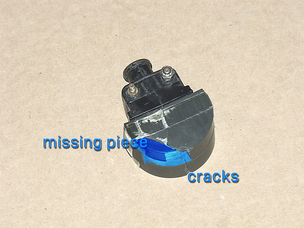

I tested resistance and it all tested fine, and i checked grounds they also seem fine. I removed the coil to sheck for cracks and it looked fine untill i accidentally droped it on the ground and the outer plastic broke off of it, i believe there were some cracks i wasn't seeing. Is there any way to put a normal car coil on or is that just a bad idea? Also is there any way to know if the switchbox is ok?
