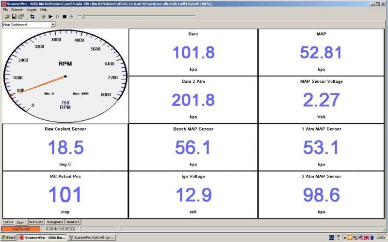

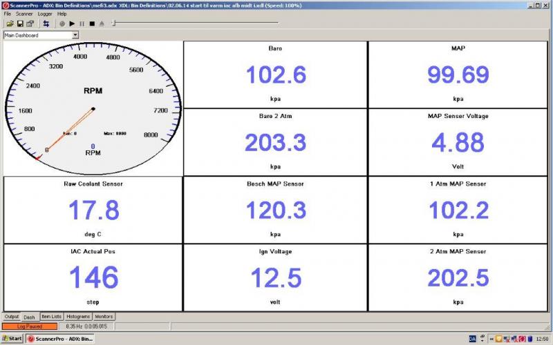

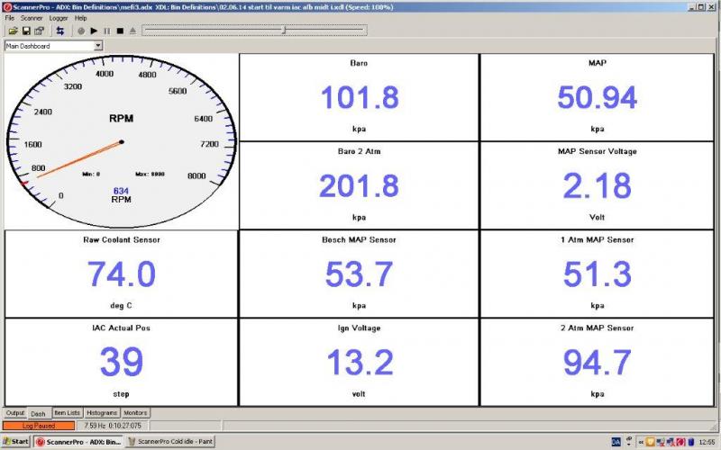

Hi , it start and runs okay , except that put on 1000 rpm it surges betwen 1000 and 1200 rpm , cold or warm. I have att. some ScanerPro screensots. New sparkplugs , fuel pressure tested and okay , IACvalve cleaned. With engine running it makes no difference if I disconnect the IAC valve . I am not that used to use ScannerPro that I am able to figure out what the problem is. I have no trouble codes shown from the MEFI 3 ECM. I suspect the IAC valve to be the problem, but I am not shure.
Does anyone have a guess ?
