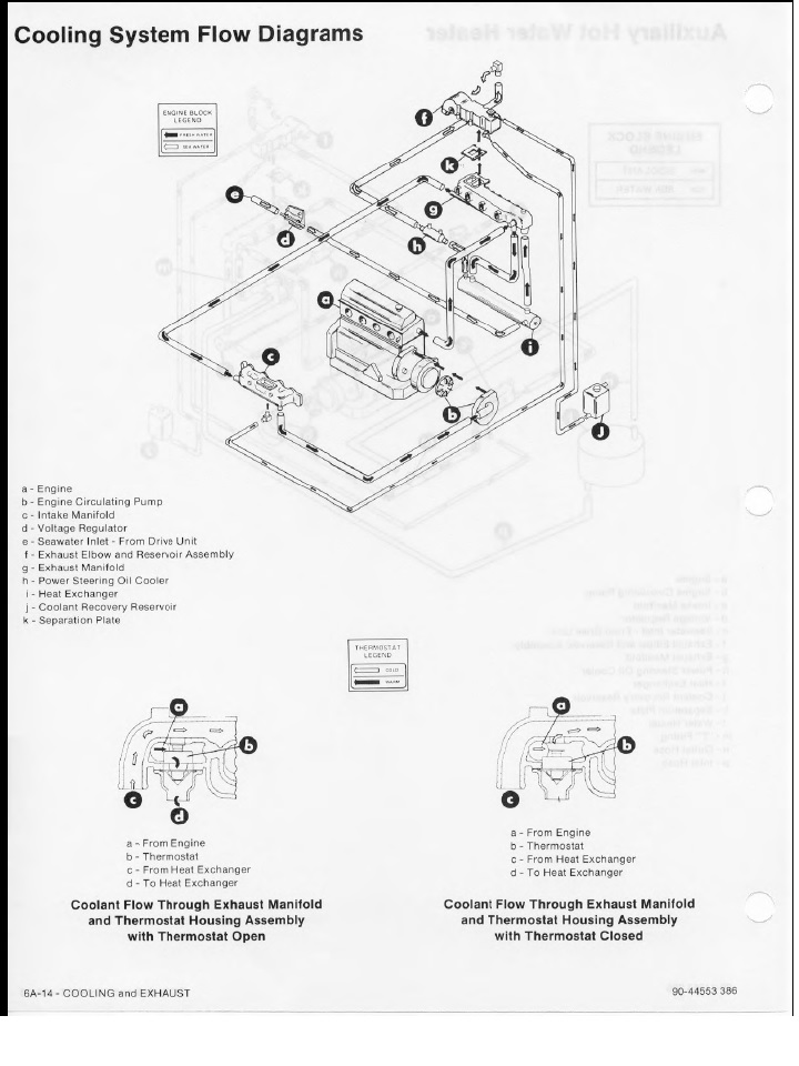

I would suggest going to a discount auto parts store and purchasing a radiator pressure checking kit. It comes with a hand pump, gauge and assorted fittings.
With the system drained, attach pump and adapter to radiator cap location on tank and pump to 17 ish PSI. Listen for leaks.
You can do it with antifreeze in system just make sure level is 2-3 inches below full, Same PSI 17 ish
If the antifreeze is coming out into exhaust it could be the exhaust manifold.
the infamous 470 has a very long history of the exhaust manifold leaking. Only a pressure test can reveal.

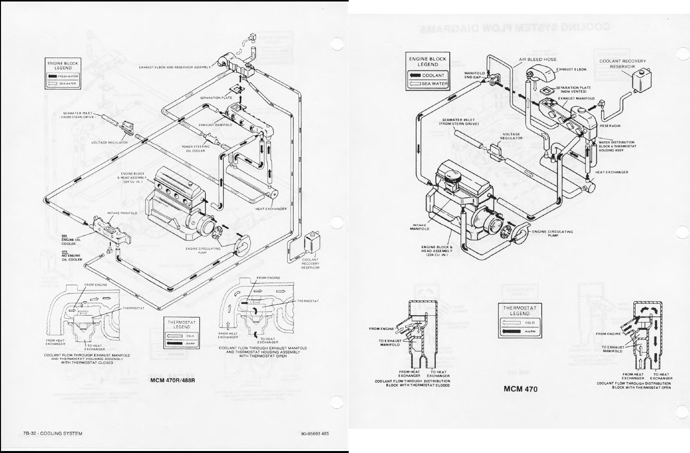

Attached here are two cooling system schematics. They are basically the same with the exception of slightly different parts. BUT the water flow both RAW and ANTIFREEZE paths are still the same with the exception of the exhaust ELBOW and Reservoir tank. Older model has separate reservoir tank where as the newer model, the reservoir tank and exhaust elbow are one assembly.
The DARK arrows are ANTIFREEZE
The WHITE arrows are RAW/SEA water.
Old system is on right side of picture
Newer system is on the left side of picture (reservoir tank and exhaust elbow in one assembly)
Old system with separate reservoir tank,
The exhaust ELBOW gasket could be a point of leakage as it is a BLOCK OFF gasket and if rotted or pin hole in it antifreeze from exhaust manifold could leak through (slow leak)
Newer system with all in one ELBOW (Reservoir tank and exhaust elbow) This part could be the issue as the casting may have corroded/warn away and is now leaking between antifreeze zone and raw water zone. Other possible issue is the same as old system and that would be heat exchanger.
The exhaust ELBOW gasket could also be a point of leakage as it is a BLOCK OFF gasket and if rotted or pin hole in it antifreeze from exhaust manifold could leak through (slow leak)
On both systems, the exhaust manifold has only antifreeze running in and out of it so if the casting has cracked/worn away the antifreeze could be entering the HOT exhaust from cylinders and being burnt off.
On both, the heat exchanger can also be the source of the leak as both raw water and antifreeze go through the assembly. This is rare but this can also be pressure checked.
It is best to remove ELBOW and Reservoir from exhaust manifold old system and pressure check all three if you can figure out how. (A lot to explain here)
Do the same for newer system but its only the Reservoir/Elbow and exhaust manifold.
When doing a pressure test you pressurize the water/antifreeze side only. so pressure in at one point, all other water/antifreeze holes must be sealed off real good.
If there is a leak it will be heard in exhaust gas flow areas (exhaust ports on exhaust manifold and exhaust gas exit to elbow) (for elbow, the exhaust gas flow area)
Make a fitting to use a compressed air connection (quick disconnect with ball valve in line to shut off air supply to test port).
If you are unable to make the fixtures to do testing, check with a radiator shop to see if they have or are able to do so. Or a marine business if you have one local

Elbows are the same design basically for closed cooling or raw water cooling. The difference as you point out is the gasket used at exhaust manifold.
Closed cooling uses a BLOCK OFF gasket system so the antifreeze cannot exit the elbow and stays in exhaust manifold and circulates in engine.
The raw water connection as you describe puts raw water into elbow and with the block off plate/gasket all raw water exits out the other end of elbow which connects to large rubber reinforced exhaust hose.
In a RAW water cooled system, the raw water travels thru the exhaust manifold, through the gasket at elbow (gasket has open holes/passages) and up through the elbow and out the exhaust side. There may be a cold raw water connection as yours has also to make sure cold raw water flows out exhaust to cool hoses at all times when engine is running.
If you have determined the Heat exchanger is good, the elbow is good (rare the elbow has any issues causing your problem) there are only FOUR possible causes left.
1. Pin hole leak in head gasket.............You would find antifreeze in oil or one cylinder would be super clean and spark plug would be also super clean as the antifreeze would remove all carbon build up.
2. Exhaust manifold has a pin hole leak between antifreeze chamber and exhaust chamber and antifreeze is being exhausted out the exhaust. (you may notice excess steam coming out of exhaust even though engine is at proper temp).
3. Radiator cap has a slow leak allowing antifreeze to leak when pressure increases. You would see antifreeze trails running down sides of reservoir.
4. Block off gasket at elbow had a pin hole leak. I believe the set up is, gasket/stainless steel gasket/gasket sandwiched. So the stainless steel gasket would be the one having the pin hole. If you cannot see it, replacing it is your only choice.

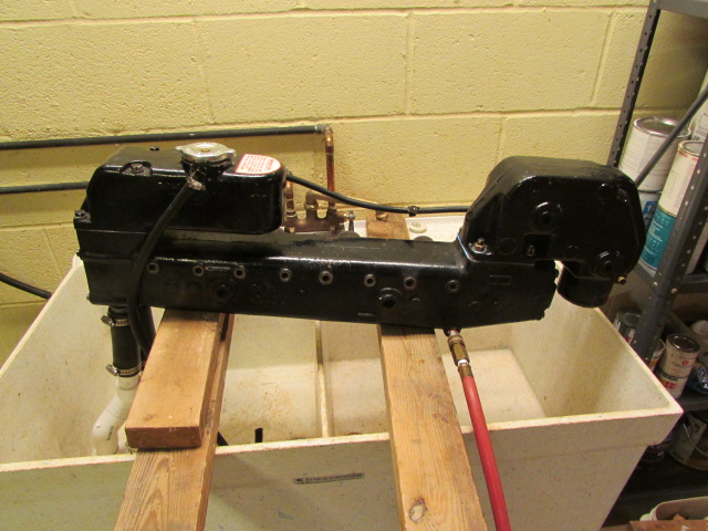

I have done a lot of work but did not make much progress in determining if my exhaust manifold leaks.
First I removed the exhaust elbow from the manifold and then I removed the manifold from the engine keeping the End Cap, Thermostat Housing, and Reservoir attached to the manifold.
I made up a connection between my laundry tub faucet and the thermostat housing using hoses and PVC pipe and fittings. I then made using more hoses and PVC pipe and fittings a replacement for the heat exchanger.
And I removed the drain plug on the manifold and replaced it with a pressure gauge.
My big problem was sealing off the flange where the exhaust elbow attaches to the manifold. I made a gasket from 1/16 inch thick rubber and made an aluminum cover plate to cover the opening.
I ran hot water at 130F through the system until it was hot to the touch. The outlet on the end cap was open and the pressure gauge did not show any pressure as was expected. No leaks were apparent. Then I closed off some of the opening on the discharge end and the gasket leaked both externally and internally. The pressure gauge remained at zero which surprised me since the leaks were not drips but forceful streams of hot water.
I then replaced the aluminum cover plate with the exhaust elbow and got the same result.
I then bought some gasket material from NAPA and before I installed it, I coated the flange on the manifold with Permatex. I covered the gasket with the blocking plate and installed the exhaust elbow.
It too leaked both externally and internally but I believe that the pressure was higher than previously before the leak started. Still the pressure gauge read zero which surprised me.
I tested the pressure gauge by connecting it directly to the faucet and opened the faucet wide and it read 75 psi so it works OK. In my test I expected the water to fill up the reservoir right to the top, and if the pressure exceeded 14 psi, which is the cap rating, I expected to see a discharge down the hose. There was no discharge and the reservoir remained dry.
As a result of all this testing, I still cannot conclude if the manifold is sound or has internal leaks.

1. Why did you use water to test with? Was not compressed air specifically mentioned?
2. Did you measure the water pressure from your supply first to understand just how much pressure it is making?
3. It is obvious you are not seeing how all the parts work so you are not understanding how to properly test.
take a step back, understand the water flow and the exhaust gas flow. Understand how block off water flow in order to allow pressure to be applied.
As mentioned, it may be necessary to make sure the parts are warmed up to expose a possible crack which my not be leaking when cold.
You said you used a gasket that was 1/16" thick...............if you can make a gasket make it at least 1/8 inch thick....................a 1/16" gasket may not be very effective in this scenario.
Also pictures of your test set up would be helpful so we can determine if what you are doing is correct.
I will also say, you did not do a proper pressure check before you took it all apart. It was suggested to use a radiator test kit to check and you simply said you could not make it work...........well It works and I have done many. There is also a check for the cap itself, Did you check that?
One other question, when running did you see any excessive steam coming from exhaust?
You've spent more in time and energy to diagnose a problem than you would have spent by buying a new manifold and riser. However, my gut feeling is that you're beating a dead horse, or rather in this case, a dead Mercruiser 470.
In all likelihood, you have a bad head. Just a guess tho. Are any of the spark plugs "steam cleaned"?
