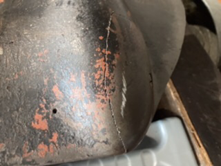

Where on the drive is the crack. On and old drive the water intake compartment had freeze cracked assume due to clogged drain hole, was able to JB weld it and worked for years since it wasnt in to the gear case.
I have the factory manuals, it looks like I only need a few tools to tear into it. I don’t think the drain hole was clogged, It was because of water entering and sitting over the winter and freezing. The crack appears pretty long.
no where I am talking about is up by the water inlet holes on the sides of the drive. I would agree with Makos comments if you got water inside the gear case your internals will probably be rusted. You can probably tear it down without too many tools but you may find the shafts are no good.

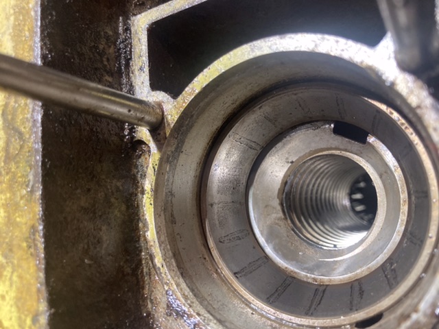

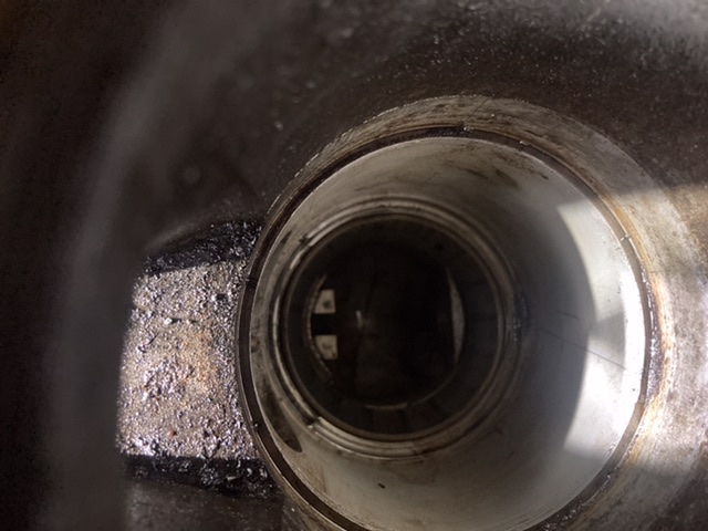

I know it’s the original unit, I’ve owned it since 1970. It has the 8 spline drive shaft and separate oil chambers, upper and lower. This picture shows the upper driveshaft bearing cup. Under the cup is what is described is a threaded sleeve, it needs a special tool other than the slide hammer to pull the cup. I can’t seem to locate that particular tool. 3DC480D2-F083-4B8E-867E-EC828855A774.jpeg

Ok, it must be a very early 67 because of the seperate oil chanbers and the sleeve. I believe its purpose of the sleeve is to act like an oil pump to help oil circulate to the bearing.
Look deep inside & you see a roller bearing just above the pinion gear & it rides directly on the shaft (just like the prop shaft bearing).

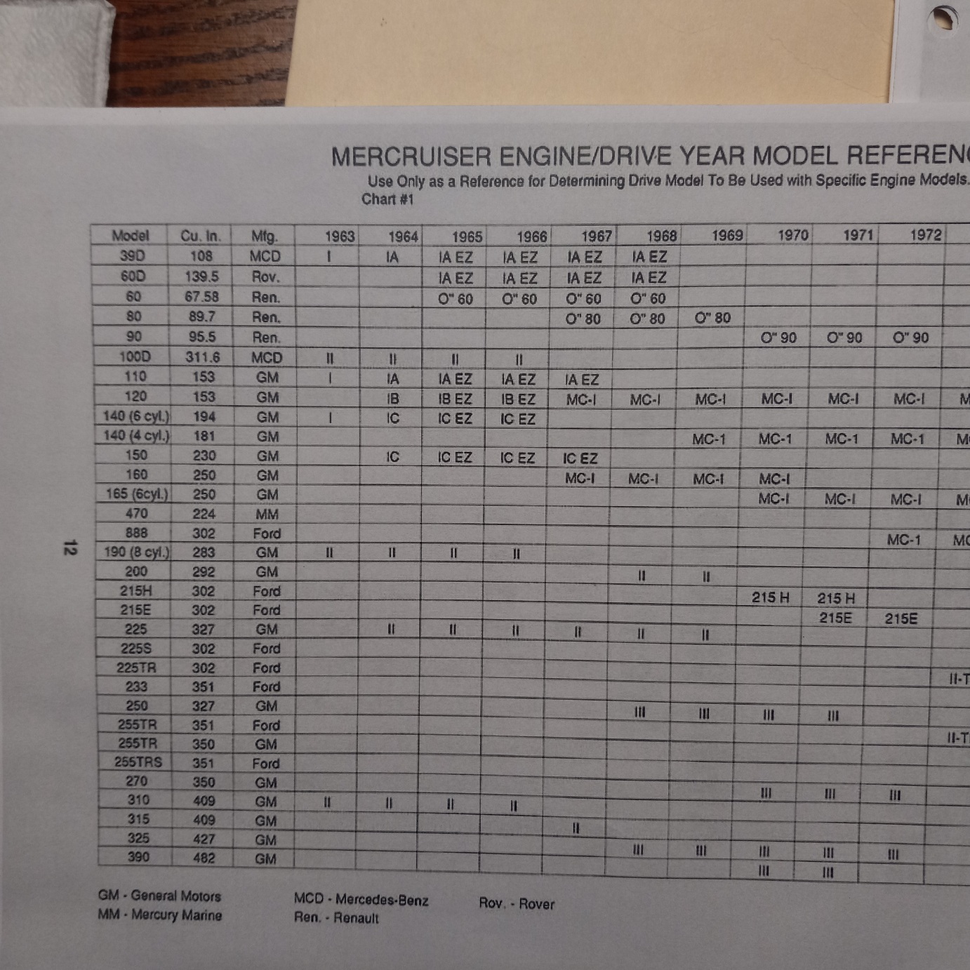

Attached are 2 pictures from MC service manual talking about interconnected & separate oil chambers. I cannot find a serial # breakdown of the change but 120 starts at 20621

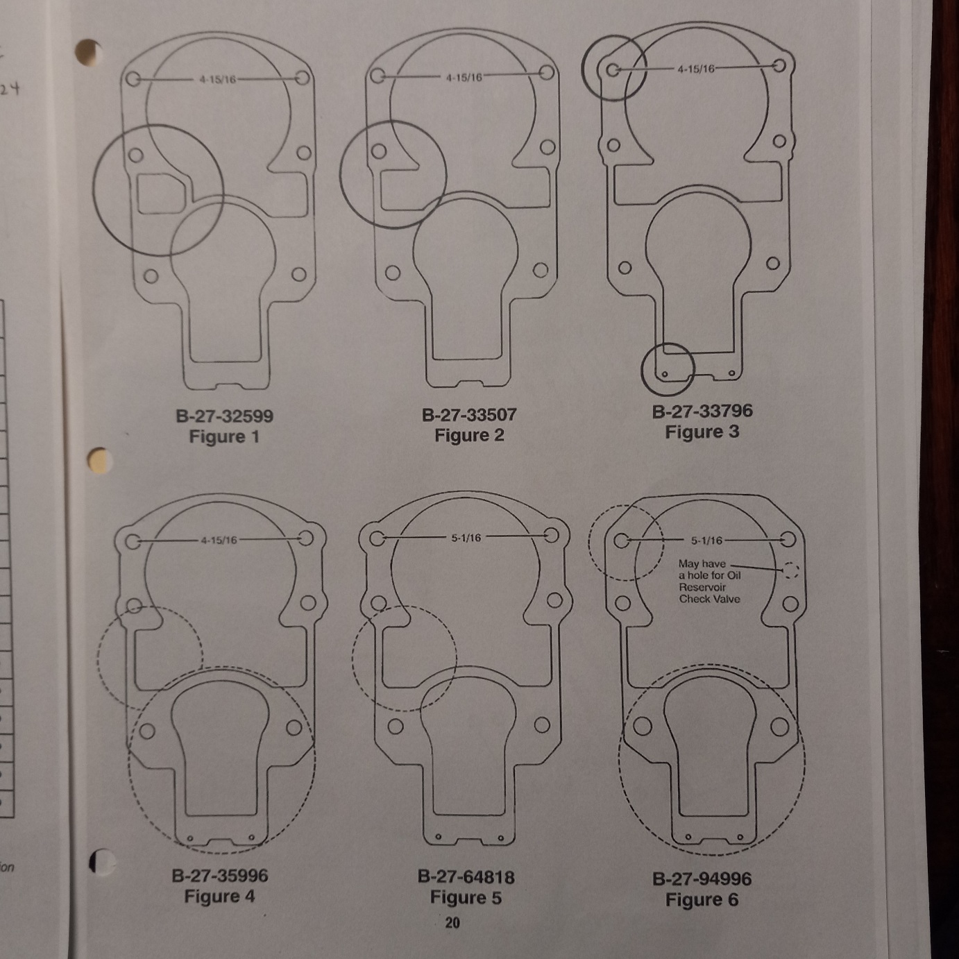

If you do have an EZ shift, it uses a different bell housing gasket. Similar but different. See the following illustrations from vintage service manual.
Also note that gasket listed for 120-140-160 shows part number 27-45821 which supercedes to 27-64818.
EZ shift gasket is part number 27-35996

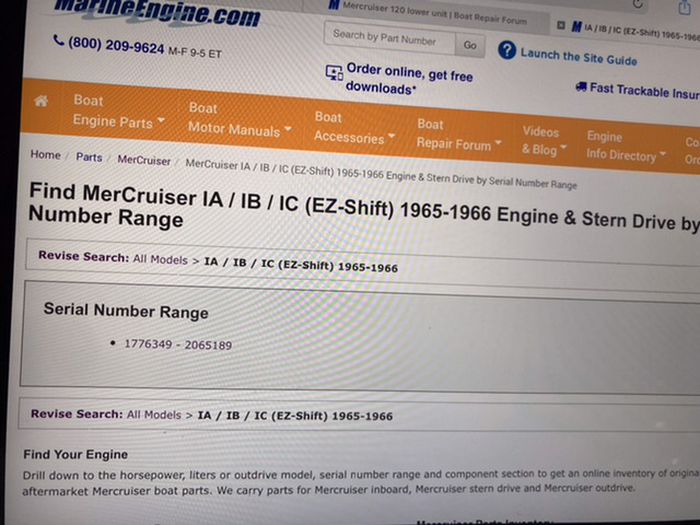

Thanks for the info, what you said about the dealer having left over crate engines is starting to make more sense. According to my serial number 2026323 it’s a 65-66 outdrive, maybe that explains why the outdrive was originally painted white. I’m still trying to figure out how to remove the sleeve. The manual shows a picture of the proper tool to remove it, I’ve looked on eBay and other sources to locate the tool but haven’t come up with anything yet. Sounds like a slide hammer is threaded onto the tool for removal.

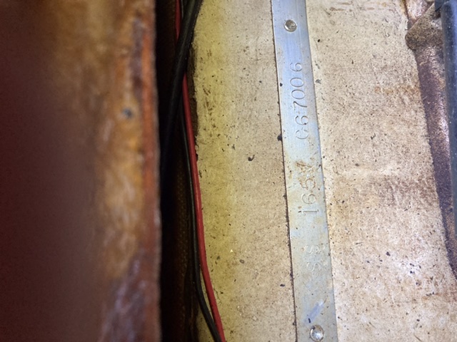

I might also add that the serial number on the transom is the model of the boat and number off the assembly line if this makes sense. Being it is stamped on the plate SS 165V C67006 must be the 6th boat built in the model year. 1967 Slickcraft

you need to be aware that the drain hole is part of a cavity not connected to the internal casing. If the crack is in the internal side of the cavity it cant be repaired.
What sleve? Are you referring the the oil slinger sleve?
If so why remove it?
Or are you referring to the roller bearing at bootom of vertical shaft (pinion shaft)?

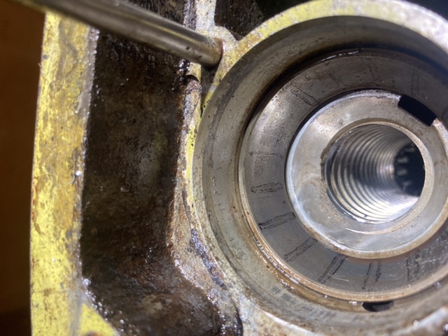

I want to remove the bearing cup that is above the oil slinger but the oil slinger is right up against the bottom of the cup hindering to get jaws of the slide hammer to grab it
Two jaw thin lip slide hammer,
It may appear there is no gap but there is.
Also, there will be shims under the bearing cup. Most likely they will get damaged. Make sure you get them all and measure each to get the stacked thickness.
to pull the sleeve, you need mercruiser adapter #91-39281...it is the threaded adapter, with the LH thread, that goes into the sleeve and allows the slide hammer to pull the assembly... a used one off ebay is the mostly likely source...
He is pulling the bearing race, is the tool you point to for that or the oil slinger sleeve?
