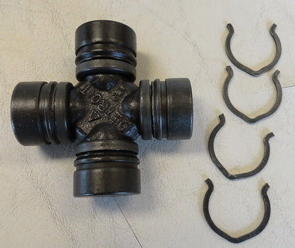

It seems there is no way to lube the universal joints or gimbal bearing on these. It this correct? Anybody know a generic number for the universals (cross & Bearing)?

Looking at an image of the cross and bearing assembly, they don't appear to have had an grease zerk fitting, if so on yours, there's no real normal way to add grease to them. Number 68, https://www.marineengine.com/parts/.../drive-shaft-housing-water-pump-gear-assembly

Thanks for the helpful thoughts. On the rusty engine, it has one rusty cylinder and 3 perfect ones. I'm pretty sure it was from rain water getting in through the carb and an open inlet valve. I doubt it had anything to do with the missing shutter, but can't be sure of course. it *looks* like the shutter is a one-piece flexible rubber thingy on a center post, but hard to be sure without locating one. Am thinking the universal is very likely a standard size obtainable from automotive sources--need to measure it up and check some catalogs.
