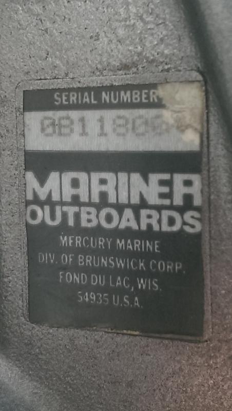

The serial number is 0B11800, and the last number i believe is 4. But it might also be 9. It is difficult to find out what number it is, since the engine har been painted.

The serial number you posted 0B11800? is recognized by the programed computer system as being a Mercury engine model not a Mariner. Typically if the engine was a Mariner, it would come up as one which also shows the HP as well. I used 3 or 4 different sites and they all came up the same as posted.
A few thoughts would be either the serial number was read/posted incorrectly, there could be two different serial numbers in different areas such as on the transom plate assembly on the outside of the boat along with another number found on one of the power heads welch/core plugs that is typically stamped into one of them for hidden ID's. Maybe somewhere along the line the engine power head and outboard assembly was changed/swapped around as that happens often.

Can you take a close up photo of the serial number/s you find along with some overall photos of the engine as sometimes that may help too.
Using the first serial number 0B106928 you found from Maxrules, it comes up as an inline 6 "MERCURY" 115 ELPTO from 1987. Here are some parts links that you could use for it.

This is not easy. Below is a picture of the serial number. I believe the last number is 4.

On the carb float casting is a stamped in number. It will be WMK-XX. what are the 2 numbers where XX is as this will tell if 90 or 115 as they use different series of carb. WMK-23, 27, 30, 35, 39 are 9ohp
