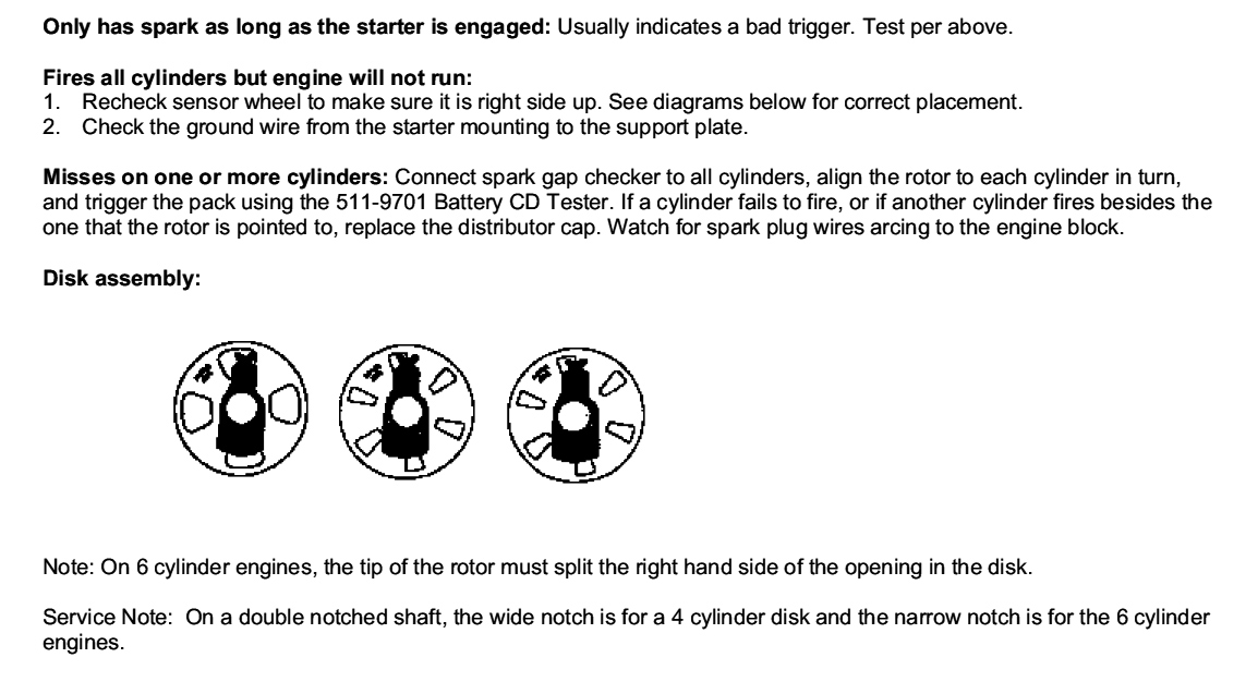

Pulled the distributor cap and took the timing belt off the sprocket. Turning the distributor by hand it fires with the rotor pointing exactly at where #1 contact would be. I'd measured earlier from where the #1 tdc mark on the flywheel is and where the timing light is flashing on the flywheel and its about 40 degrees btdc. So, pulled the distributor and found some corrosion on the shutter wheel at cranking rpm's. Thinking maybe the corrosion is causing some issues with the sensor. So, gonna look and see how the dang thing comes apart so I can get the corrosion cleaned up on the underside of the shutter.
Guys... I may have messed up. Got the distributor apart and the rotor/shutter was nasty on the underside too. Got it cleaned up and as I was going back I realized the index tab is not centered in an opening or solid area area, meaning there is an up and down side.... I always make a mark or take a picture when I disassemble something new to me. Unfortunately this time I took a picture, didn't think about the rotor not going back either way. Looked for a you tube about it and searched this forum without success.
This is from the CDI instructions PDF it might be similar as to the position of the rotor trigger-disk.jpg
