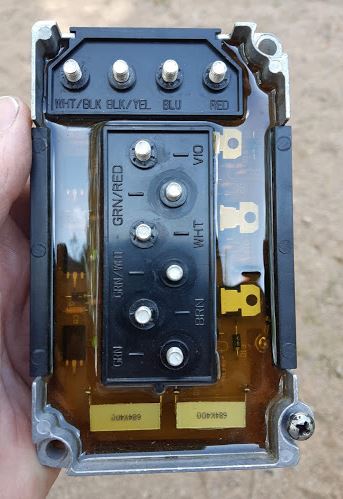

Solved.
Switch box failure.
DVA from green wires was not increasing in two cylinders. Causing misfire and also set ignition way early.
DVA was 200V@idle and dropped 190V when accelerating.
Only one cylinder DVA was increasing from 200V@idle to 280V and in that point motor was misfiring badly and more rpm couldn't be accelerated.
Again cheapo switch box causing waste of time and money. That failed switch box was new..
Here it is. No any marks on it.
