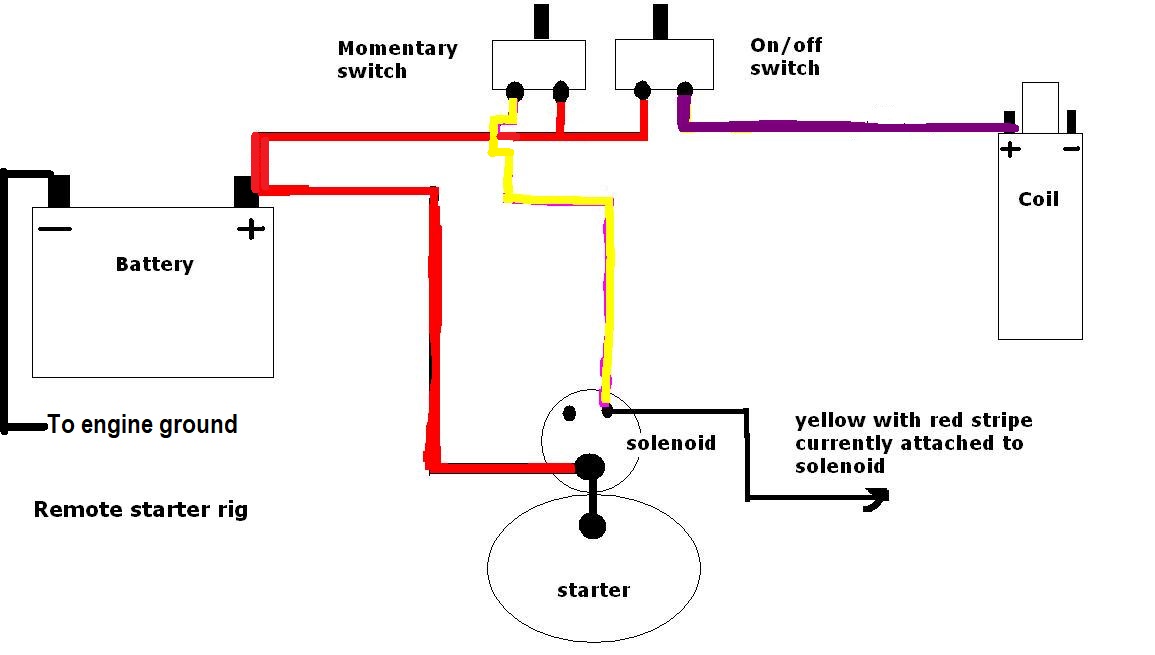

Yes you can start it without the drive, you can also jam a hose in the water port on the bellhouing and run it this will supply cooling water. A washing machine hose cut in half works great to jamb it in thereI JB welded the thing and got it back in. Is it okay to briefly start the engine before putting the drive on?
