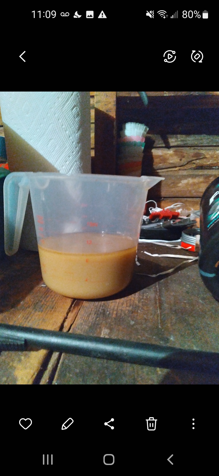

The creamy looking stuff on the left is after 4 days in the water trolling about 2hrs a day. The stuff on the right is new. Should the lower unit oil look like that? There wasn't any water drain out first. It just drained out slow. I hav a video but it wont let me load it.
I no when I changed the impeller last year the rubber housing with the 6 bolts was chewed up a bit on the inside of it. If you guys think that is water in the oil would that be the reason?

it does look like water in there though. I have definitely seen worse...but this is after only 4 days of use....
Either way, this needs to be addressed. Use a quality-rated MARINE gear oil... and might be time to change the seals..

I just went and looked and the oil in the cup still looks the same as it did on Thursday.

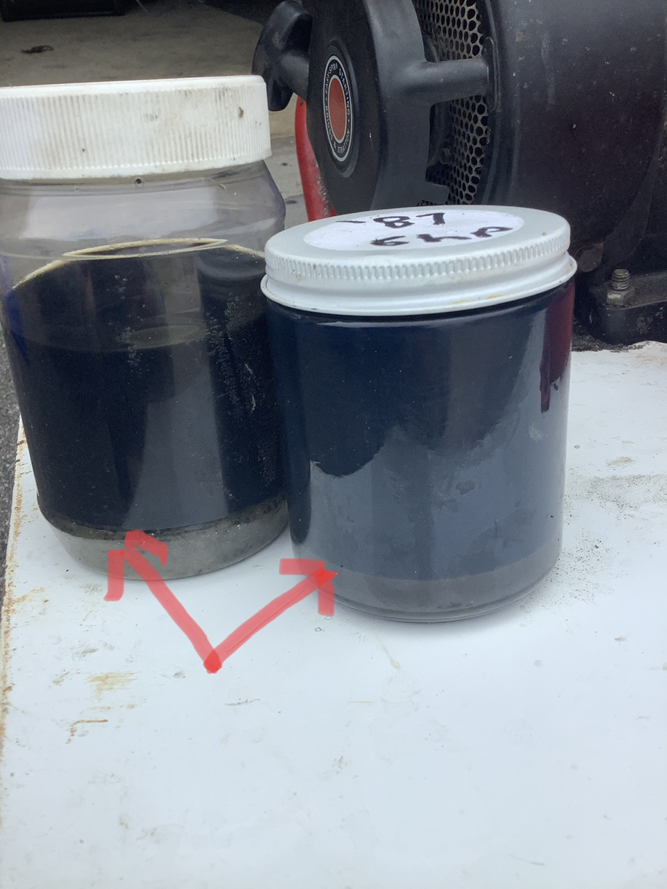

Pour it into a clear glass jar. Let it sit for several days. If there’s water, you will see a definite line near the bottom of the jar.
letting it sit in that opaque cup won’t tell you anything. The water will separate out & sink to the bottom, it’s denser. The remaining oil on top will always look like oil. You can’t see through your container sides to see if anything seperated.
edit…I just looked at your last container photo, it will probably be visible in the measuring cup, I was looking at your margarine container.

Ya I don't think it's going too it's been a week now and it's still the same. I have a new Johnson water pump kit here that I got today. Hopefully get it in tomorrow.
There are some high-tech fluids that will absorb and hold water but frankly, I don’t believe the lower gear oils you buy for outboards, especially in the lower horsepowers are in that category.
in the last several years, I’ve had a dozen outboards that I’ve draiNed into into a clear cup container and left sit for several weeks. Every one of them, with water in it, separates as per the pictures I posted.
The systems we’re talking about are not very high tech. It’s a pinion gear, driving another gear. Been around for about 100 years now.
I'm going to leave it there to see if it does happen . Wife doesn't want her cup back now anyway.

So it's been a month and the oil went back to the color of fresh out of the bottle with no water In the bottom of the cup. I've tried to show pictures but it won't let me.
