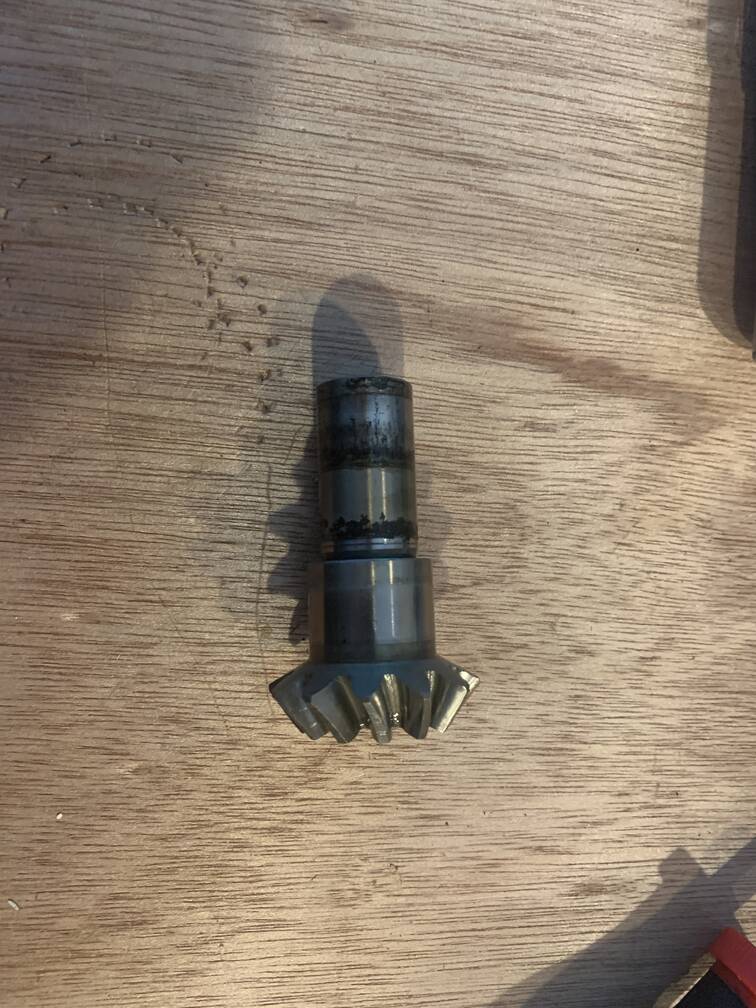

That does not appear to be a factory original bearing for the 28 HP model.----Without more pictures it be hard to tell.------Was there a needle thrust bearing under the bearing in the picture in post # 30----The 33 HP models did not use that pinion strap as per parts diagrams !!----Post pictures of the pinion gear .

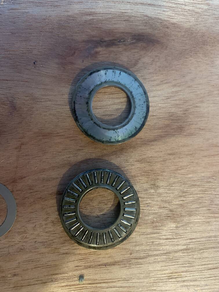

Yes, there was a thrust washer underneath the bearing housing. Ive attached photos of the pinion and the thrust washers.

One last try here.----Hopefully I can make it clear.-------You do not have the original 1962 model 28 HP lower unit installed.----So you need to run to a shop with a " grey haired " manager.----Find out what you have and install the correct parts.----Put the hammers away and listen.
Ha.....well said! Also, I don't like the looks of that thrust washer and rollers. Time to call Tim's Outboard in Hackensack MN. Talk to Teresa, Mike, or Dan. They will send you the correct parts......they probably have them in large quantities. I have a few, but not sure where they are, my shop is a mess. Need Racer or Joe to help me organize....besides that I'm loosing my short term memory.....forgot what they call that!
