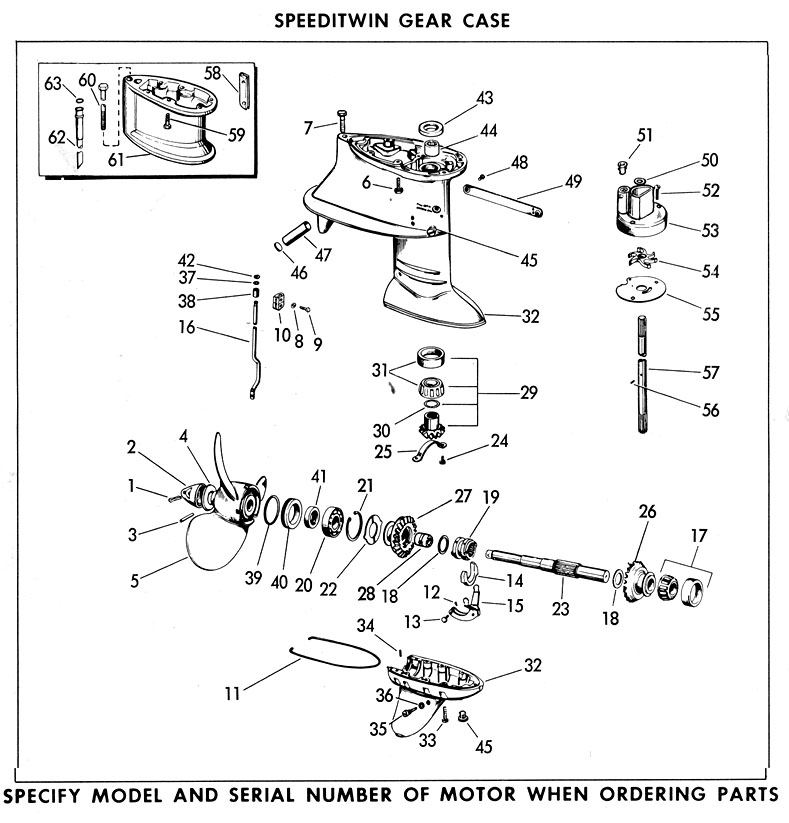

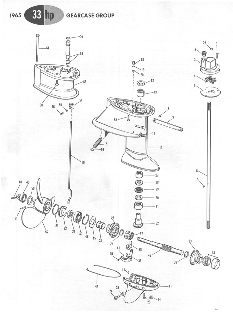

I'm convinced you have a 33-35hp gearcase. Totally different pinion/bearing setup. I'm surprised you don't notice the different pinion.
Or are you trying to put 33hp parts in a 28hp gearcase?
Or am I wrong?
I'm convinced you have a 33-35hp gearcase. Totally different pinion/bearing setup. I'm surprised you don't notice the different pinion. Or am I wrong?
Wow, it’s so weird, I have like a combination of the two. The pinion is definitely for the 33 HP but mine also comes with the bar that goes across pinion to hold it up, shown in the other photos. Where can I find that part number for that part? Looks like 31 on that diagram.

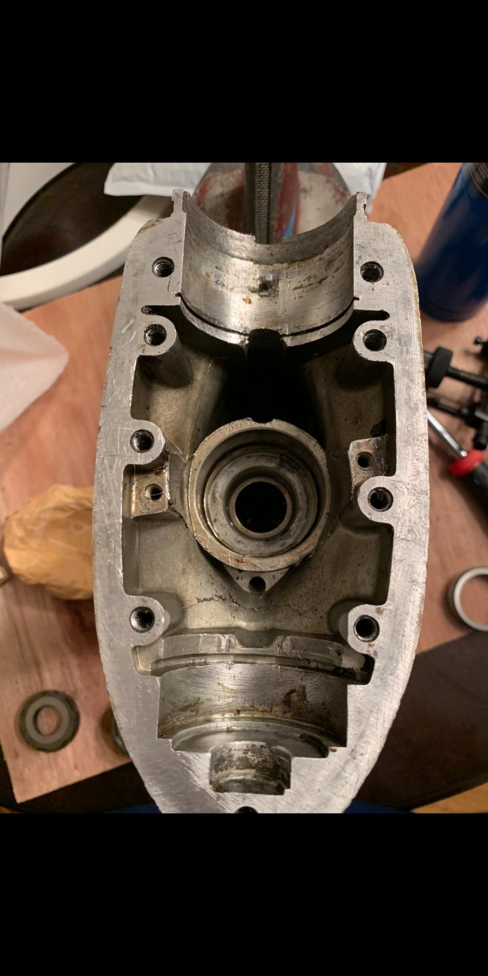

Okay I got photos. Sorry, should have checked sooner? Looks like the 28 horse housing for sure, but had no pinion retaining strap? But the holes are there for it. That bearing that came out doesn't look correct. Somebody has been in there before, but that new bearing should fit. Did you measure the new bearing and the housing bore size difference?
The last picture with you holding the bearings appears to be almost the same size.
I probably have that pinion strap here. Let us know how you have proceeded.
