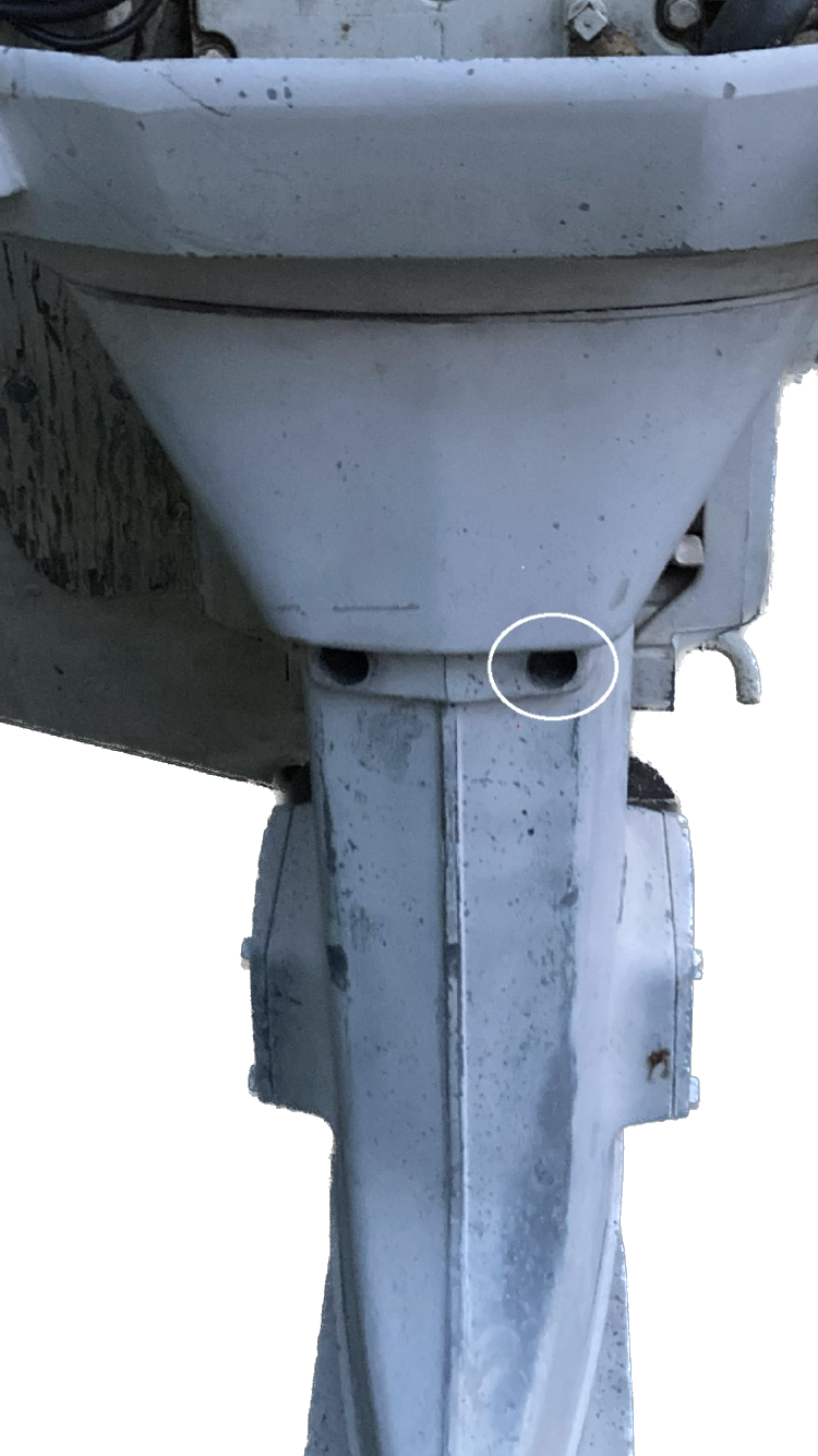

I uploaded a picture to show the location of the holes at the back and the hole the water comes out with a white oval around the hole the water I’m planning to do a compression test today. If the compression test is good I am planning to change plugs and impeller or do a full water pump change. I attempted the compression test two days ago but the battery wouldn’t turn the motor over, all it did was make a click when I turned the key.

Does having water coming out of the hole in addition to the tell tale water coming out indicate an overheating condition in the motor or is it a normal occurance to have extra water coming out of the hole plus the tell tale water? Why is water only coming out of the right hand side hole and not on the left hand side hole?
The C means nothing to you.------Water should spit out of both those holes at idle.-----More water comes out at full throttle.-----Lots of manuals available.

Well, he said the motor was running fine and he was using the boat till the last time he took it out, before COVID, when he noticed water coming from the hole on the right side. Would water coming from only the right side indicate a blockage on the left hole or could that still be normal operation of the motor?

The C identifies any mid-year engineering changes for that model IF any mid-year changes were made. Otherwise, it means nothing. Water is supposed to spit out of one or both of those holes in varying amounts.

That is normal for that water to come out of the other hole. I have the same exact motor and it has always done that. Maybe the guy just never noticed it before.
