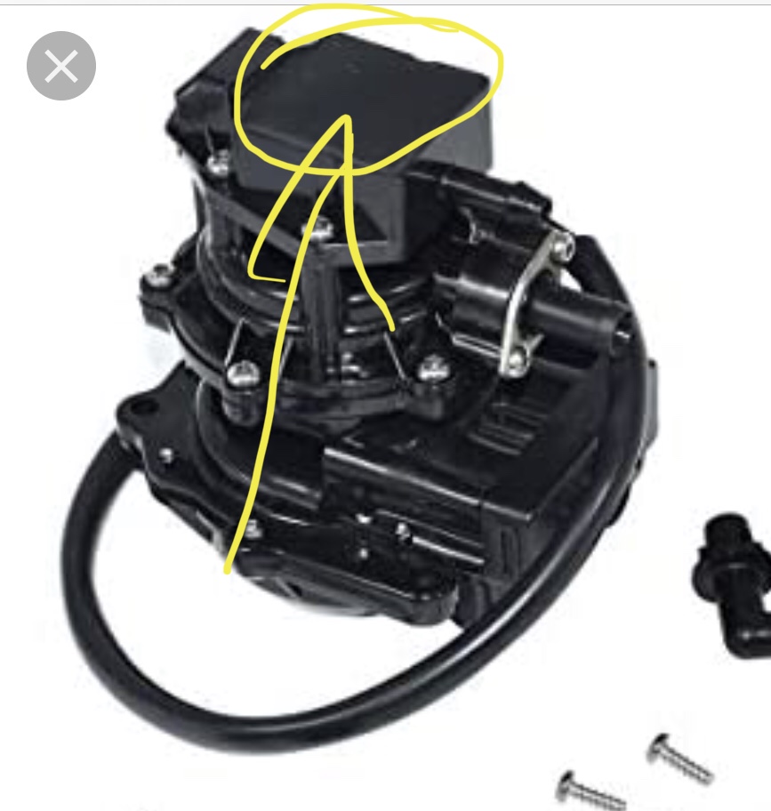

That seals the electronic module for the " no oil " warning.-----Not a problem if it is soft.------Have to ask , why are you working on or replacing this pump ??----What is your motor doing / not doing.
