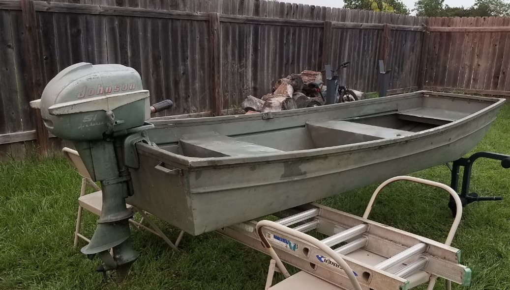

It tops out at 6 mph on my 10ft flat bottom. The same boat does 5 with a 2.6hp and 8 with a 4hp.
