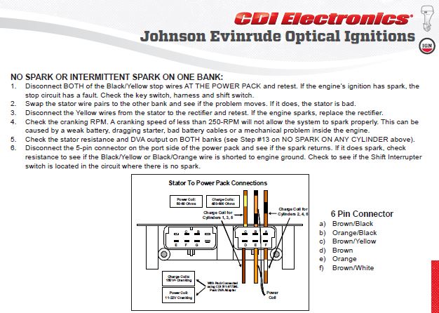

hi guys, i have a 1997 175 will only start on three cylinders the right side everybody says it the power pack so changed it now the right side is not firing and the left is tried unplugging the switch that cuts out the cylinders still only 3 cylinders even in neutral i cant get it too fire on all 6 any help would be greatly appreciated. thanks for everybodys time,
