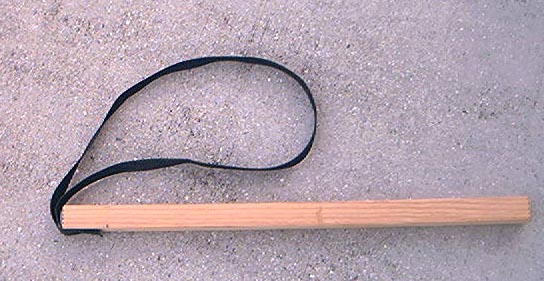

I will try to test the stator with plug tester as Faztbullet suggested and hopefully I don't have to replace the stator. BTW, how do you guys immobilize the flywheel while undoing the top nut? I realize I will need a harmonic balancer removal tool to lift the flywheel, but I have to undo the nut on the top of the flywheel and the torque is pretty high there, while the flywheel is spinning freely.
I use a strap wrench to hold the flywheel. If you don't have one big enough you can build one out of a piece of wood and a nylon strap at the end. I have also use an old electrical extension cord attached to the end of the wood. Just make sure the wood is at least 1" thick. It takes a lot of force to hold back that flywheel and anything thinner may just snap.

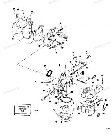

Now, the next thing I guess would be to sprinkle the soapy water and observe for the bubbles. If there are no bubbles, it's time for replacing reeds due to the age anyway, right?
For that I need these parts - 52, 53, 51, 49 and 2x 48. (2 reeds, manifold gasket, plate to crank case gasket, reed stop set and a shim) on this picture
I found this kit on ebay. Not sure what it has in it for $25. Just emailed seller.
I am kind of inclined to replace it anyway. Age of the engine, my curiosity. Please warn me if I am going wrong route ))
