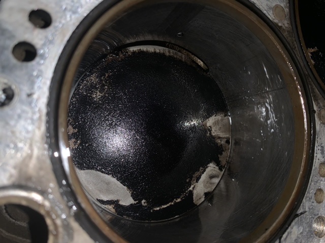

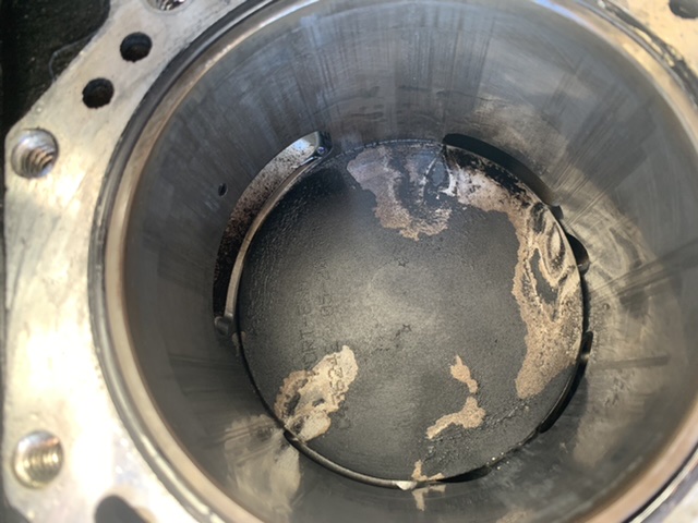

I finally got a chance to work on the boat again this morning, it’s been a little chaotic recently. I removed the cylinder head and the head looked fine, but the piston had a buildup of black stuff on it. The cylinder walls looked ok as well5C4C294A-4CC6-45EA-9115-6B16FC1F4A2A.jpeg
So I put the cylinder head back on and ran a bunch of Seafoam through it, it seems to be running much better now, no more stalling. Still need to take it out to see if I can get over 2500 rpm in the water. Tested the compression and still have low compression in that #3 cylinder. Do you guys have any idea as to what could be causing it. I ordered a new O ring for the cylinder head to see if maybe that’s the problem. Other than that I’m not sure where to go from here about the low compression. Piston didn’t have any play and there was no scoring, I rebuilt the carbs so that’s not the issue. What else could be causing the low compression?
Cylinder #3 has marking on the cylinder wall.----Some will argue.----I would take this motor apart for a look at that #3 piston and rings.
