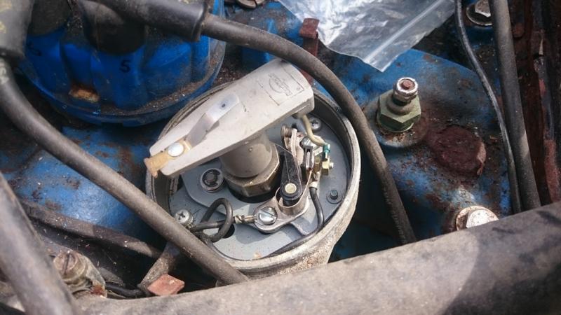

Is this a prestolite distributor? upgrading to elec roller+flat cam compatible dizzy
FstaRockr Burns
Hi there - is this distributor on my 1976 prestolite? I am not familiar with for distributors -
Need to know cos some of the kits ask what type I have - otherwise I might just get a complete distributor, however some of them are modified HEI ones and dont support roller cams :(
bit confusing
a snap on cap and a thin outer housing is Prestolite and a screwdown cap is Mallory with a thick housing
Your looks like a snap down so its a Prestolite

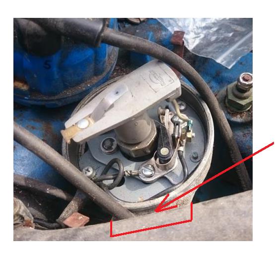

Question:
What is this portion of the aluminum housing being used for?
If this extends to support a vaccum diaphram unit, you have an Automotive Ignition Distributor..... NOT GOOD!
(see red arrow)
