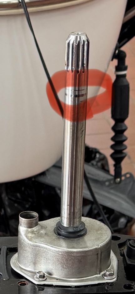

Hello! I’ve replaced my impeller and ready to put this back together. However, I’m concerned about a potential missing o-ring on the drive shaft. I’ve watched so many videos and looked over schematics and can’t see anywhere this is addressed. I also have one additional o-ring in my impeller kit. Should there be an o-ring here? Also, if there should be then the old one is probably up in the upper unit. Any advice on getting it out?
Thank you so much for any help.

That's wear from the O-ring in the housing above- Assuming you change the impeller semi-frequently, if you put grease on the splines, some will coat that when you reassemble it.
