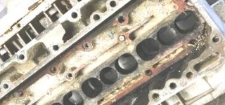

fellas.......its going to be another day before i get a result. i took the starboard side middle cover screws out but its stuck in place. its too dark to assure i have an adequate place to get leverage. these come off in twos right? if i have to replace the gasket i realize how hard the bottom one will be. i am fully willing but let me ask.
am i just trying to see what size this motor is or is this the path to make it run ? you guys are really all i got and i fear the thread will grow cold if we wait a week or so to get a new gasket and install it....
You can use a suitable prying instrument to leverage the middle port cover off, against either the bottom of the top cover, or the top of the bottom cover. They're strong enough to stand up to the prying.
When you get around to needing to pull the top and bottom covers, just bolt up the middle cover with enough bolts to hold it firmly in place, and pry away! Works like a charm, and this way you're not inserting prying tools between the cover and the block, and potentially damaging one or both surfaces.
I've done this dozens of times and it works Slick.
To answer your other question, not knowing the correct hp of your motor will make it extremely difficult to troubleshoot. If it had never been messed with, it wouldn't be much of an issue. But at this point with the mish-mash of cowlings and serial number, there's no way to tell if the jets in the carb are correct or not. A set of jets isn't extremely expensive, but it's a fair amount of trouble to change the jets and you don't want to waste $$$ ordering 2 sets of jets, then installing the 1st set to find out they're not the right ones.
And if it is indeed a 150, then there are other things we've gotta look at besides carb jetting.
IMHO better to know and then we can help you better. Chances are it could be a 150, but I wouldn't stake my life on it!
ok guys.....the cover literally is bending out of the way of the tire iron i used to pry. maybe someone glued it. ill try a different one tomorrow. i keep running out of light. sorry guys.... i promise i am committed to this. i wish i had someone to look at it. i live near lake allatoona in georgia and STILL nobody wants to do this old of a motor.
guys i got em. this is the right panel correct? i dont know what you could possibly tell from this but...let me know..sorry theyre sidewaysIMG_0395.JPGIMG_0396.JPGIMG_0397.JPG
