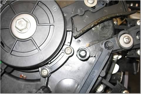

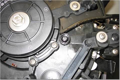

It not a block problem....check to see if upper linkage has moved and is set up correctly.
Top pic is incorrect and bottom is correct

Thanks! I will look at it when I get off work today
and post my findings! I have not taken it to a shop yet. I'm on the verge on letting it go. Kinda want a new bass boat anyway!! Would you know wjere the idle set screw is at btw? Or how to adjust the upper linkage
And also, just outta curiousity so I understand it, how can it effect the idle? Since I looked at it this morning it's definitely in the wrong per the picture you posted!
Update* adjusted the upper linkage, that was simple enough so far lol, didn't change anything, what next to check? Idk why my idle rpms keep dropping!!
