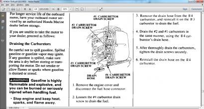

5) To drain, connect a tube to the drain spout on each carburetor float bowl, and loosen each drain screw.
I found the details in the owners manual, but picture is terribly vague. DrainCarb.jpgCarbScrew_Drain.jpg
Guess I need the Dummy guide! Can you tell, I have never done this? Someone told me to simply follow the instructions in service manual!
Just loosen that screw in your picture and gas will flow out of that little metal spout just behind the screw. Do this to each carb. If there is a lot of crud in there the spout might be clogged, just remove the screw completely and they will drain out the screw hole.
