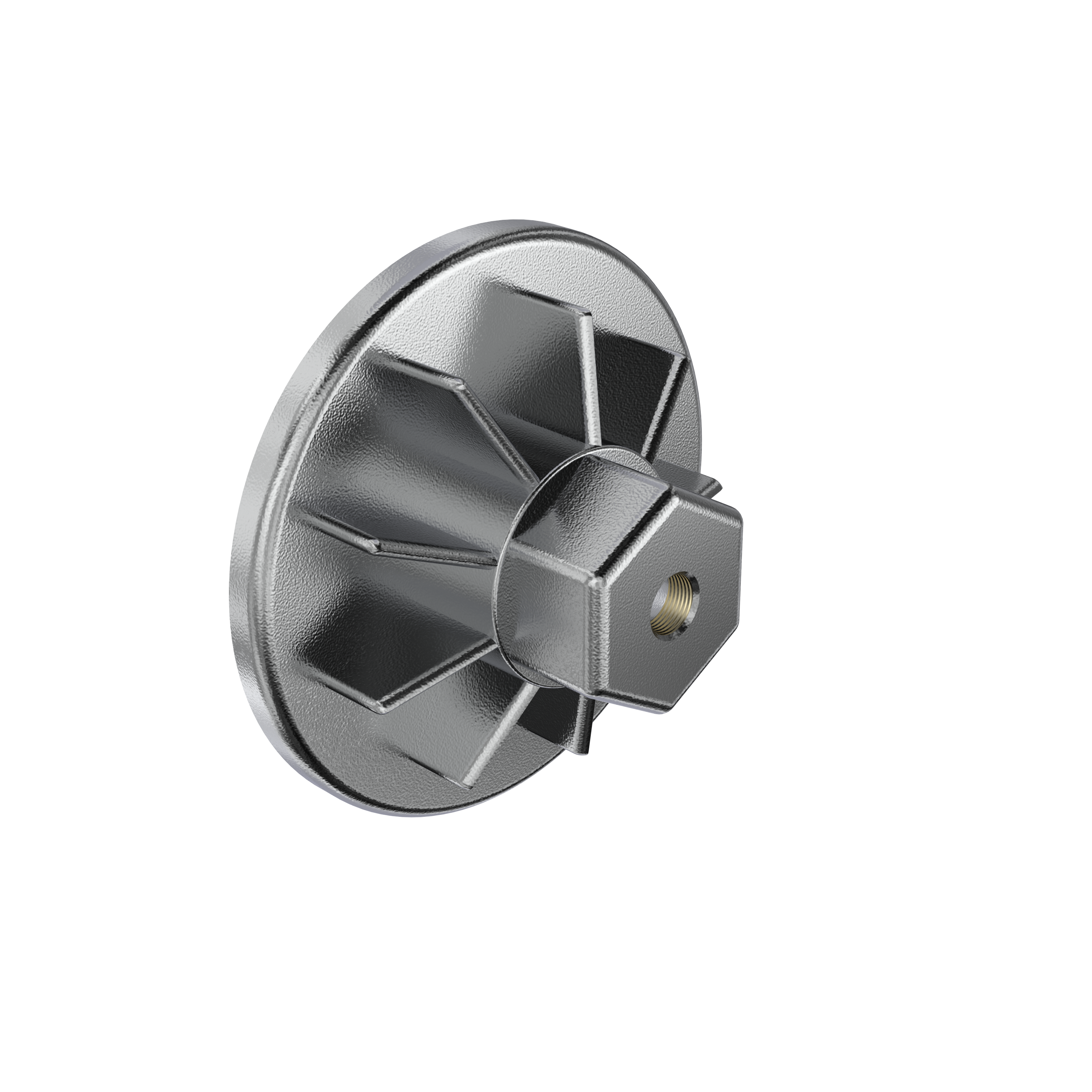

I do have that prop tool (885127) - It was very cheap even as a genuine volvo penta tool. I also have the prop tool 3855876 which is more like a big box spanner. I purchased both tools because I'm sure I'll need one, or both, tools.
I found a diagram online that shows a breakdown of the prop and the parts and it shows the part I'm looking at - the part I'm trying to work out how to remove is the visible part with the fins - in the diagram here it's part number 44.
BTW I'm pretty sure that the prop tool 885127 is needed to remove part number 42 in the diagram but I won't get to that until I've removed part number 44.

  • 0003348_volvo-penta-280-dp-290-dp-propeller-removal-tool-part-number-885127_550.jpeg
Found the prop nut in question...Looks like all you have to do is remove the center bolt and washer (45 and 46) and 44 oughts to just pull off with little effort and no turning as it's flat on the back side as suggested in the available photos of VP part number 852201.

Hi,
Just an update - I got this off - It came off with a 24mm socket (I'm a bit surprised because this is just under 1" but I didn't have any big imperial sockets to try with me). It was tight but came off with a normal counter-clockwise thread.
Derek
Another update - I got part # 44 off with the special tool (885127) but there was no way I could do it without a cutoff 3 foot metal tube slid over the tool handle to get enough lever on it to undo it. Again this was a standard counter-clockwise thread (so actually both props are held on with a counter clockwise thread although the inner prop has a big washer with tabs that lock the part (#44) from turning so i'm guess it must be the counter rotating prop when going forward.
