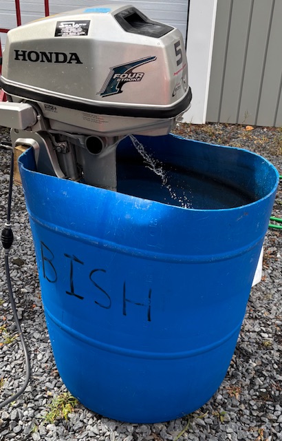

My post regarding a 5hp sounds like it was being how your outboard is being used- infrequently. The thermostat was plugged and lot of salt crystals in there.
I ran the 5 hp a barrel in vinegar and water yesterday, without a thermostat installed for 20-30 minutes. Using an ir gun on the top of the thermostat housing, it got up around 80f iirc. Drained vinegar water and refilled the barrel with fresh water and with the thermostat installed, the housing would show 120-125F, which is the range for the thermostat to open and close. If your new thermostat opens and closes like that, your cooling system is likely clear?
Infrequent use is bad for these small outboards in both cooling systems and fuel systems. They really don’t get hot enough when used little to keep the cooling system cleaned out and also typically don’t get flushed with fresh water.
The fuel system needs close attention, fresh ethanol free 91 or higher octane and nice clean fuel is needed, plus if possible, nice long hot runs to keep varnish from appearing in the carb jets etc. I’d recommend using a dose of Sea Foam in every tank of fuel to keep it cleaned out. It also eliminates water from ethanol or from water in the tank.
JGMO is the pro on these small carbs and the process to follow to clean them properly once they have been varnished up from lack of use etc.
Can you recommend a water vinegar ratio? Perhaps 10:1 or 20:1? I assume this will help dissolve some deposits/ buildup? Thanks, -Ken
Ordinary white vinegar is 5% acetic acid , I used 8 liters in my blue barrel and filled it up to about 3 inches above the anti cavition. 2 -4 liter jugs. I’ve used 4 jugs in my 130 hp with a full barrel.
This barrel was about half full at most, I’d say 75-90 liters.

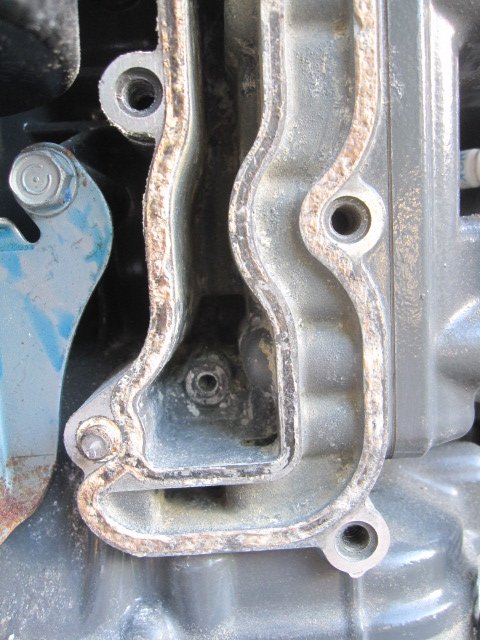

I found a blockage at the bottom of the water jacket where the anode should be. It appears that one or two passages to the bottom cylinder were blocked. It cleaned up easily, and the ports seem to be clear. Broke the head off one bolt:). Ordered anode, bolts, & gasket. I'll put it together and try again. Thanks for your guidance, hope this is the root cause. I wonder what the stuff is? Feels like packed salty sand/grit. Probably my bad for not flushing often enough or long enough.
Yep, good going! Way to follow through and stay ON IT!
That "gunk" is, in many ways, like a furry critter that likes warm, dark places to curl up and take a forever nap.
Sorta reminds me of my cat.
It seems you found it before it's had a chance to solidify and become "one" with the aluminum.
That's a GOOD thing because there could be more in places that you can't see.
Doing some serious time running it in the vinegar solution after you put it back together is recommended. Just keep a close eye on the water temperature in the tank when doing that. You want to avoid overheating even if the protection program works like it should.
Since the water exits through the lower case and prop hub, you will probably be catching stuff that breaks up and will be able to examine it in the bottom of the tank if you drain the water out carefully.
