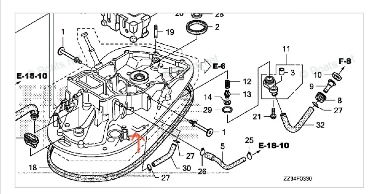

Hi JGMO, thanks for the detailed explenation. But the clogging is only on the fush port side and I'm looking for a way to get to that from the inside. The flush port is going in by a 90 degrees pipe and the problem is directly after that.
Well, I don't know. Do you think that yours is a "factory" set up and came that way? If so, I listed everything I could find on the parts pages except the flush cap on the stbd. side under cover. I'll include that now. See item 1 in the link below
You can see the page reference for that component's associated parts back to the F-3-30 page that I attached in my first reply. The only item I see that resembles the 90° pipe you describe is item 32 on page F-3-30 so I don't think that I'm understanding what it is you're wanting to do.

Thanks anyway for your support. What I wanted to achieve is remove the blockage from the inside, the 90 degree flush port is completely blocked
the 90 degree pipe I mean is where part 30 going into the motor
Yes! That is page F-3-30 which I initially posted (without all the pop ups) and explained that there's a 90° turn to that passage that can be a "catch all" for debris that causes blockages to form. As I indicated before, if you think the blockage is "in there" you can use shop air to try and clear it. Try first going into the port facing forward then switch to trying the port facing left or port side to see if.you can get movement. You can also try a stff wire or a long shaft mini screwdriver to see if you can make any progress. Harbor Freight sells those little screwdrivers in very long sizes and they don't cost much.

Yes, it sometimes breaks my brain why engineers would come up with designs like that. You would think that a 5 year old playing with dolls would know better than to put an INACCESSIBLE, 90° passageway for a critical fluid encapsulated in a major component but there's the proof that it happens.

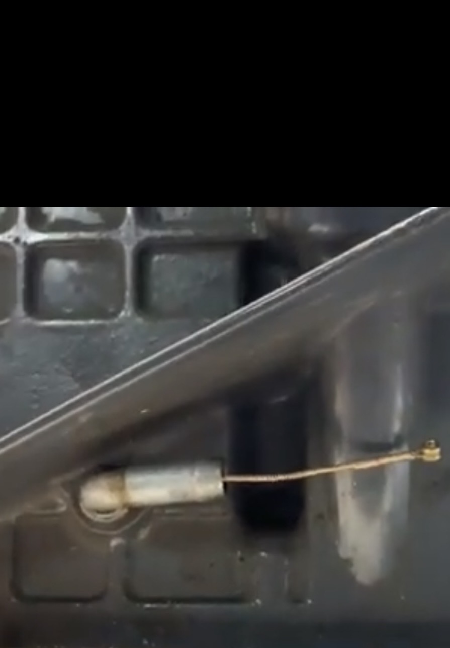

je hoort ongeveer 5 cm in het kromme buisje te komen daarna kom je tegen een intern kanaal je kan het proberen met stukje van een binnenkabel van een fietsrem het kabeltje in een accu boormachine zetten en zo schoonfrezen wel voorzichtig beetpakken als het kanaal ook dichtzit dan werken met een lange slang 50cm die op het kromme buisje zie afbeelding 30 en volgieten met antikalk of zoutoplossing 24 uur laten staan en met perslucht door blazen dit blijven proberen tot het risico is groetjes Timo
Did you resolve the issue?
David, I solved it like Wormerlander / Timo suggested "You should be able to insert the tool about 5 cm into the curved tube before hitting an internal channel. You can try using a piece of a bicycle brake inner cable: insert the cable into a cordless drill and use it to ream out the blockage (hold it carefully). If the channel is completely clogged, use a long (50 cm) hose attached to the curved tube (see Figure 30), fill it with a descaler or saline solution, let it sit for 24 hours, and then blow it out with compressed air. Keep trying this until the blockage is cleared. Regards."
I did the same a few months ago. In addition I also use the outer brake cable to avoid winding up the inner cable. It fits just inside the curved tube
