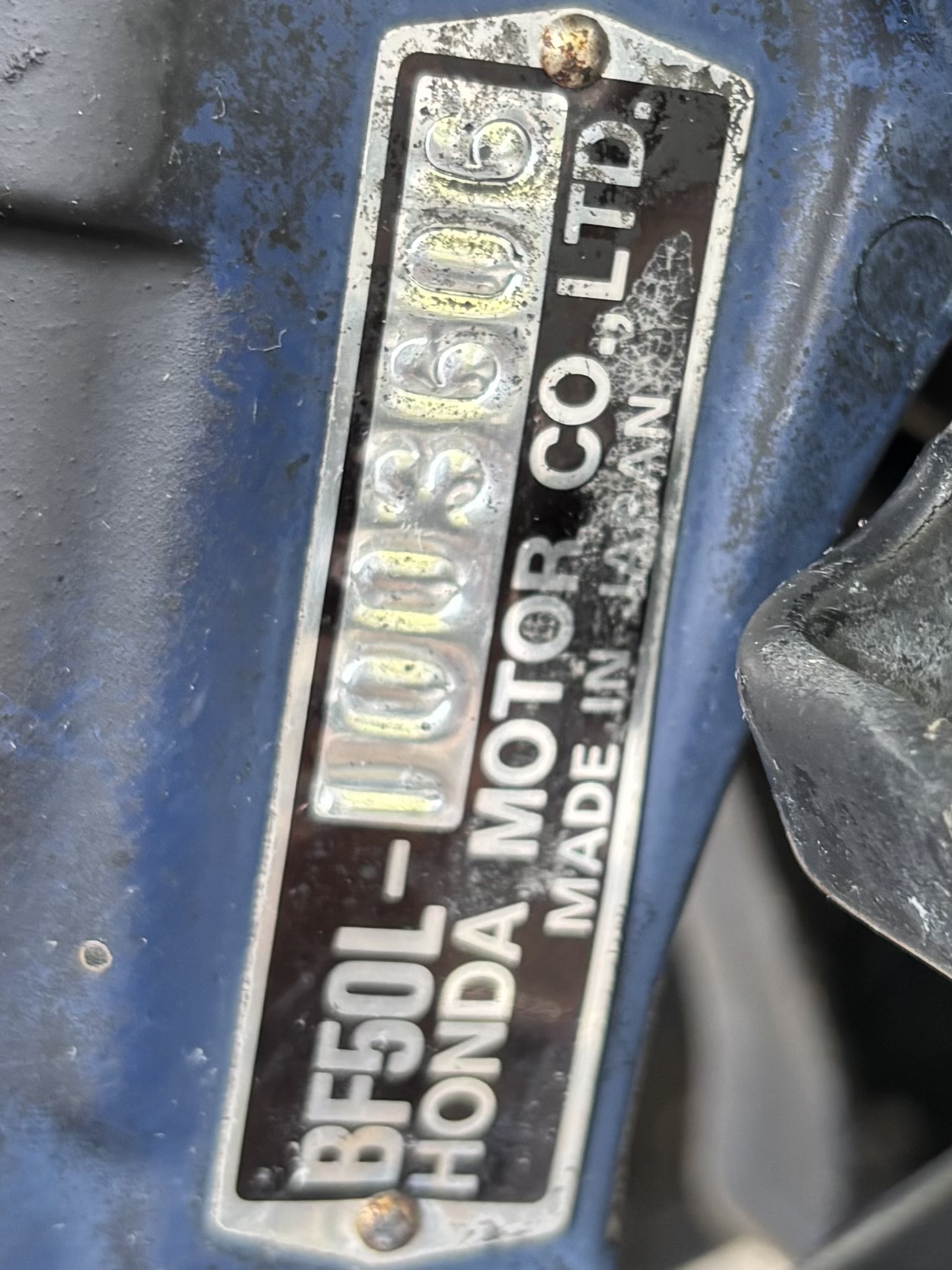

The 5hp kicker stalls once underway on slow/low rpms. I believe it’s a fuel delivery issue. Cleaned carb, bowl, jets needle…. Cleaned fuel line, changed inline filter and checked and cleaned fuel pickup in portable tank. Nothing terrible or obvious was found. Run fresh rec gas non-ethanol too. Pump the bulb and it runs for 5 minutes and the rpm’s begin to drop if I squeeze the primer bulb it goes back to normal. Want th know what’s causing it. Could it be the fuel pump diaphragm? I examined it and its intact looks a little ballooned. However, it doesn’t just lay inside the housing but is somehow attached to the pump case and a shiny piston-like piece on the opposite side. Anyone out there knows what the process is to change it or do I buy a whole new pump? Thanks for your advice. Edwin

I’ll look at that again. It is a cam drive for this fuel pump. That’s on the inside of the crankshaft chamber “shiny piston-like piece”. I’ve ordered the new pump. $100 when all it probably needs is the diaphragm but there could be a wear spot on the back piece or a lube. Thx again for your advice and know how.
Well, Honda spare parts disappointed me. There is no longer a fuel pump replacement for this motor. Does anyone have any idea on replacing the diaphragm instead of replacing the total fuel pump? Let me know if there’s a way to source a solution for this. Thanks.
