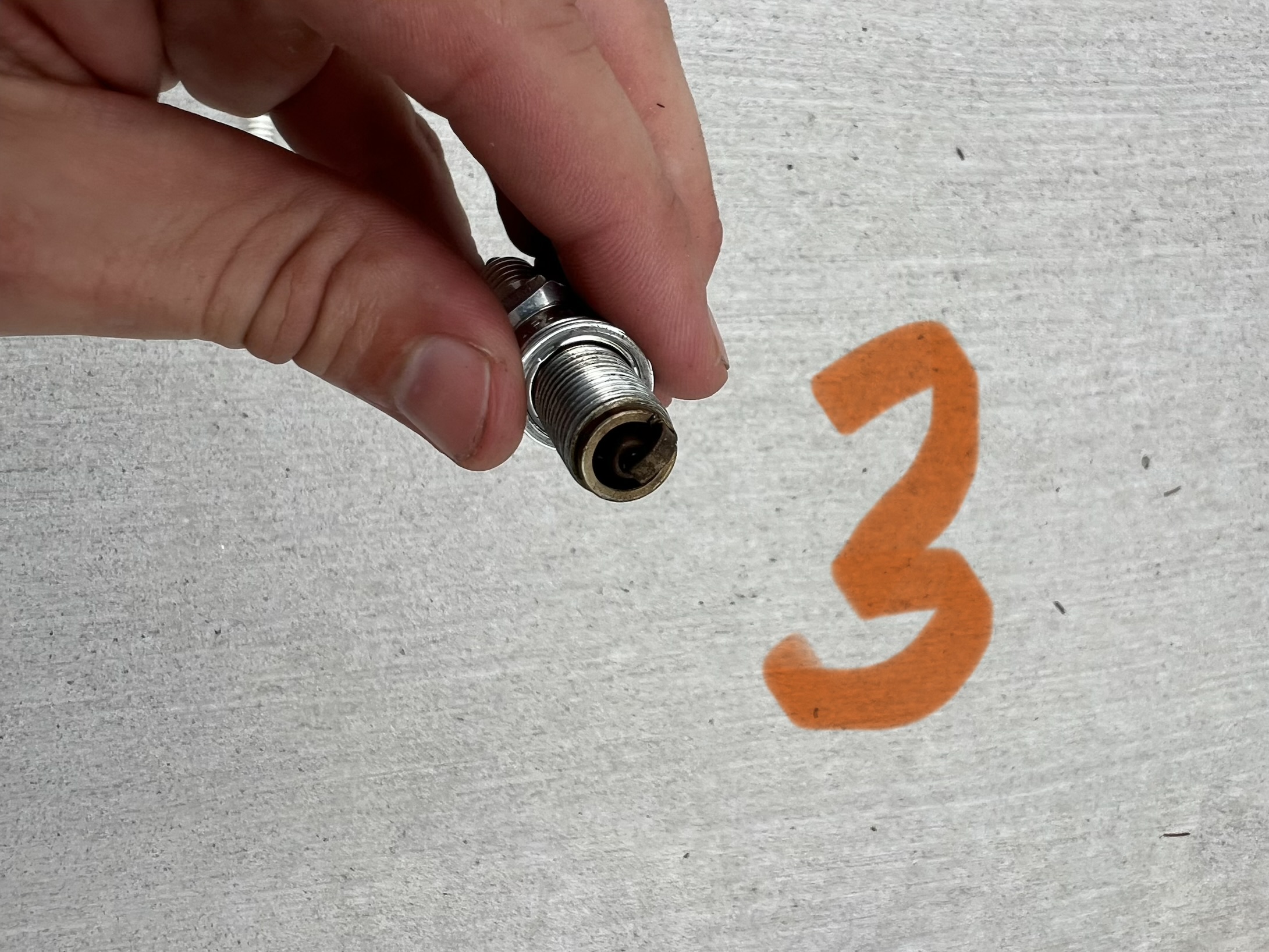

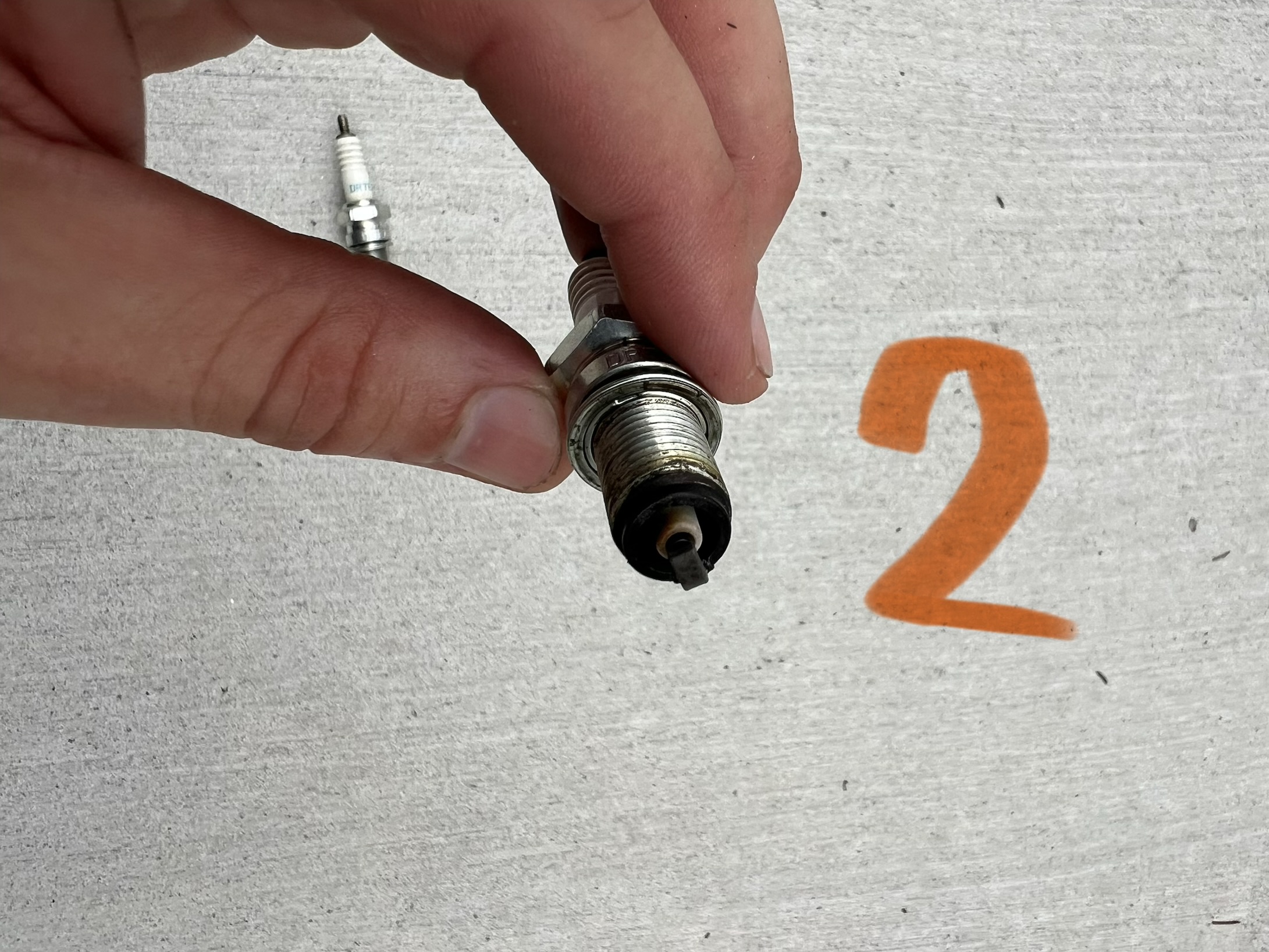

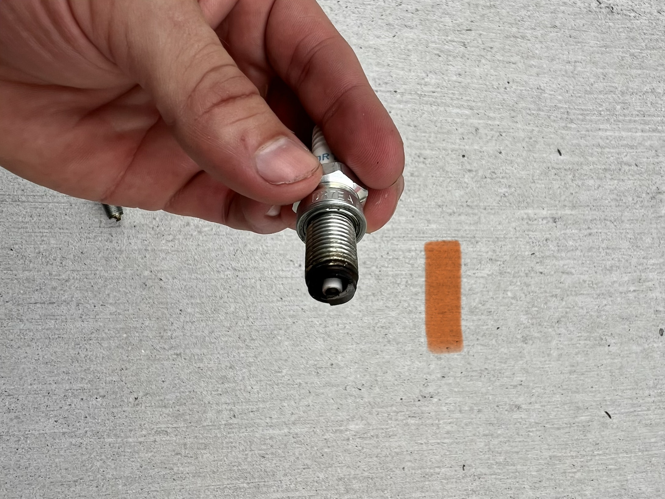

Considering it’s a 2007 I’m happy with that and eliminates cylinder issues. I uploaded pictures of the three plugs, again not a mechanic. Can you tell anything from these? I’ll check timing tomorrow. One thing the service manual isn’t clear on is the difference between exciter and pulse coil?

Are those plugs original?
The plugs support that there's been ignition at #1 and #2 and little to none at #3. But, because it has only run on two cylinders and then on only one for a brief time, i can't read much into what I'm seeing there. The bottom plug looks so fouled, it may not be capable of firing at all.
You may want to consider a new set of NGK DR7EA. I don't recommend cleaning plugs but people do.
Compression looks great but racerone may have a good point about checking the valve clearances.
Engine compression is a good indicator of general health and valve train operation but many engines will still pass a compression test with misadjusted valves. At 160 hours I would expect practically no wear but I've also seen plenty of engines shipped from factories with loose or missing bolts and nuts. None of us or our assembly machines are perfect.

I just re-read your original statement and realize I missed that you said coil #3 was replaced by the dealer. If so, the coil not firing could simply be the result of a bad connection someplace for that coil. Sitting 10 years gives moisture a chance to build corrosion in connections and gives little critters a chance to do what they do in dark spaces.
I apologize for skipping that piece of possible vital information.
I hope you find it!
Definitely change the plugs and run something like sea foam in the gas, a high dose. Those 2 plugs are badly fouled, your valves and cylinders may have a load of crap too, the sea foam will help clean that out. And adjust the valves as suggested.
Also, did all fuel filters get changed? If those plugs are that ugly, maybe the filters are ugly too. 10 year old fuel will be very ugly and if the dealer didn’t do new plugs, the filters are suspect.

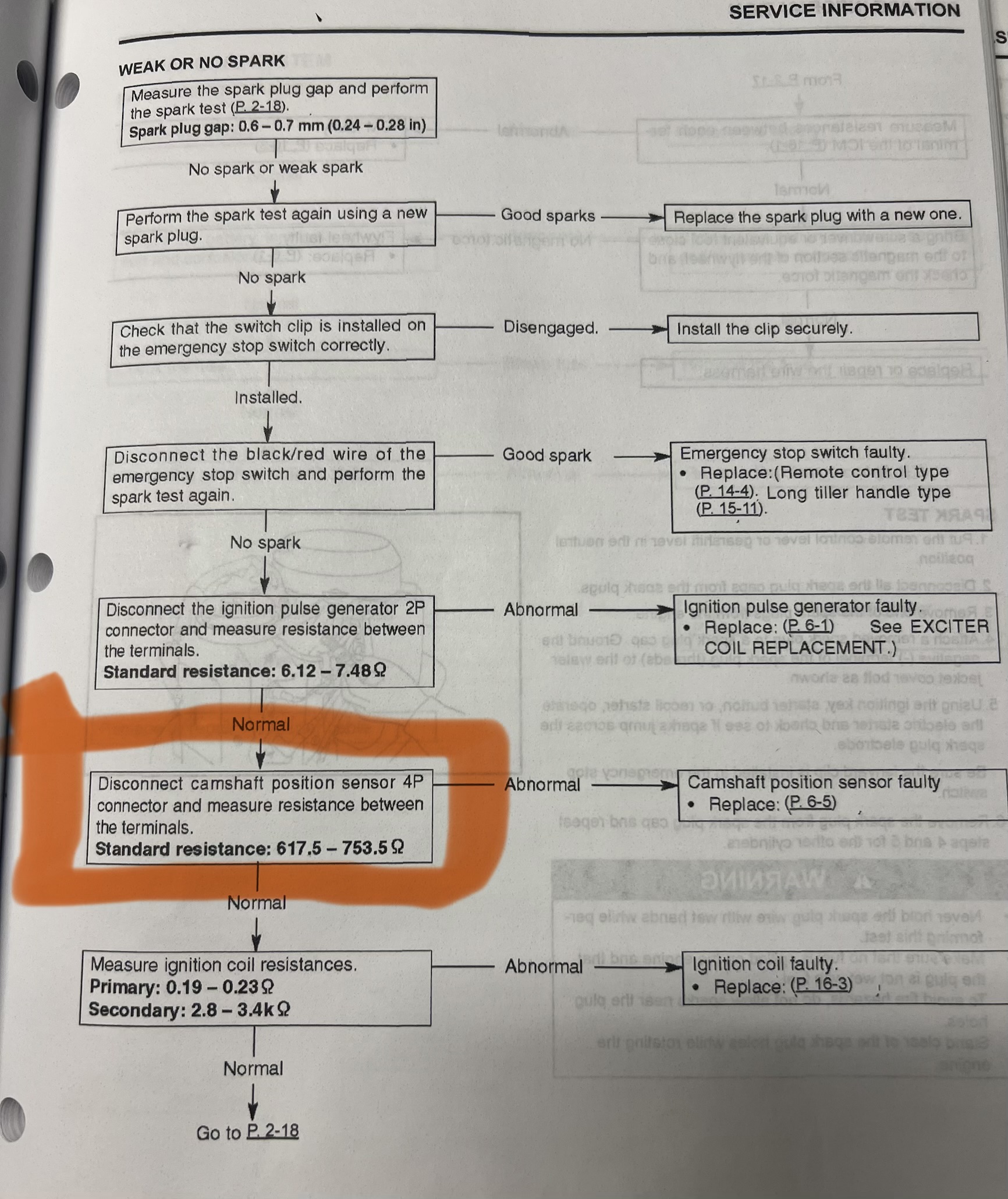

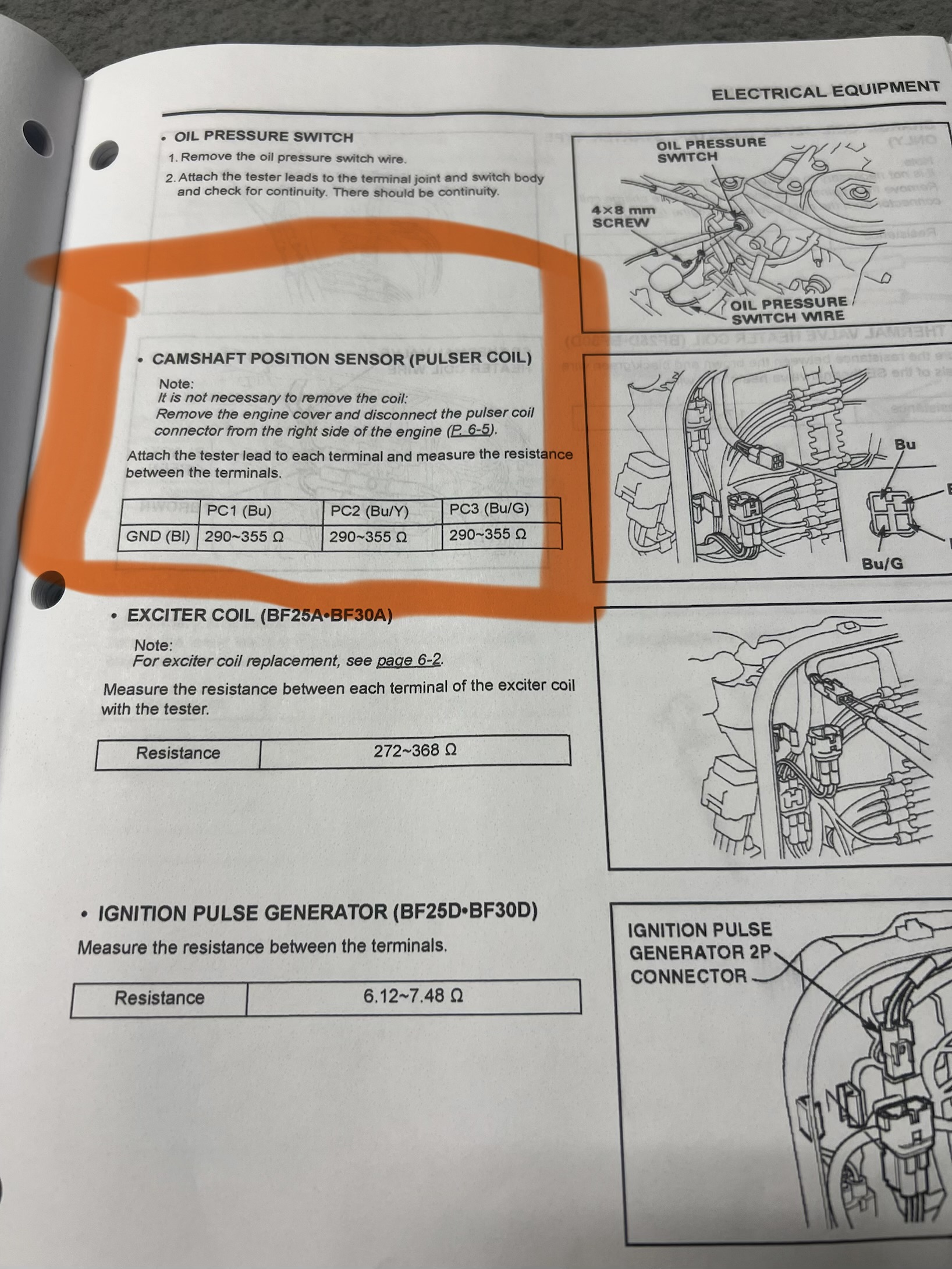

I have not checked timing or valve clearance yet as the meter came in early. I went ahead checked the resistance on the following
Ignition coil 3: primary .21 (within spec)
Secondary 3.3K (within spec)
Ignition pulse generator/exciter 2 prong: 7 (within spec)
Here’s where I am a little confused as the manual has two different numbers for the pulsar coil/ camshaft sensor 4 prong.
I tested the 3 prongs against the ground - I’m assuming each one is for each pulsar. 2 of them were around 680+-ohms and one was 1400 ohms..I think this is where I’m having an issue?
The manual shows two different specs for this I attached in photos. Maybe one for A series motor vs D? It doesn’t specify. I’m guessing since two of them were within spec of the one on the troubleshooting tree that is my number?
Anyways thanks for the help here I’ve learned a lot so far and enjoying it. I’ll report back with timing and valves shortly. I’m also planning on taking apart the carbs, and just double checking the dealers work…after reading the manual JGMO you were right…I have zero trust in anything they did. I’m not even sure if they looked at a manual!

Also the spark plugs are brand new, they were changed the first time I brought the motor in about 2 months ago (well according to the dealer). I’ve ran the boat a few times and it’s idled quite a bit while I’ve messed with it in my driveway but that’s about it. I’ll try the seafoam
Actually I was wrong. I had the wires crossed. All three pulsars measured within spec at or around 680. Kinda stumped here. Worth digging into the CDI tests or give the carburetor a shot?
Figured I’d come back and update. Main jet on bottom cylinder was totally clogged. Also the float bowl on the top cylinder was clogged where the starter enrichment feeds in.
Issues were totally solved and now the engine fires right up
