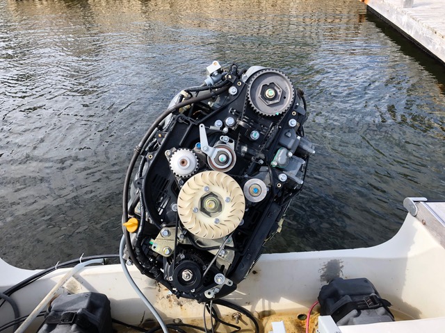

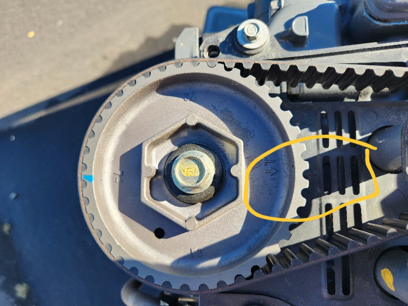

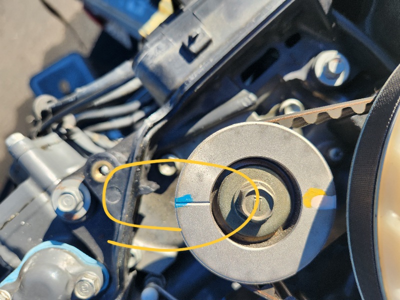

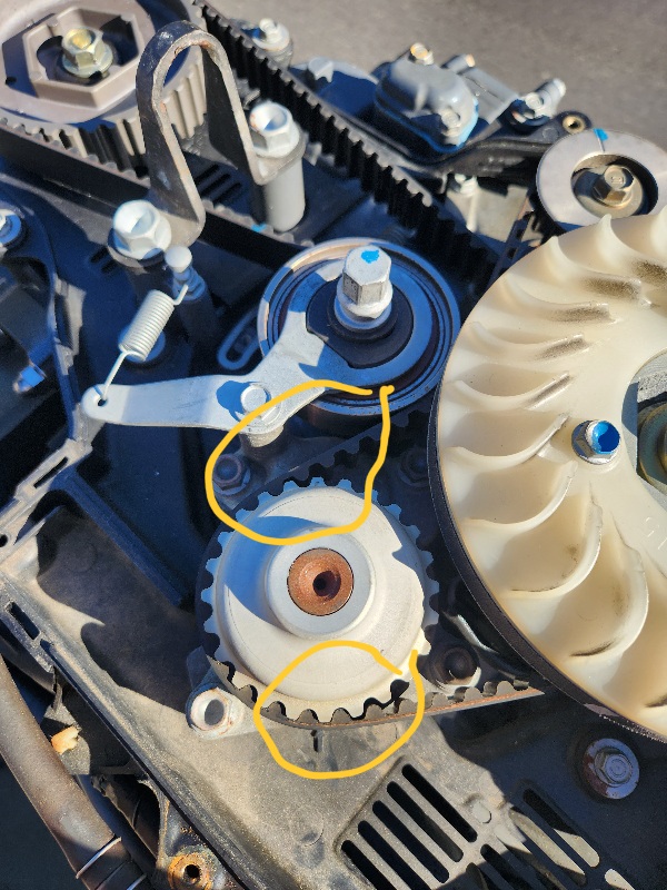

I'm trying to check timing alignment. Everything seem to line up properly. The only thing I'm not sure about is the line on the intake balancer side. On the intake balancer shaft, there is a dot that is 180 degrees from the arrow, is that suppose to be like that? The manual I have doesn't even mention the balancer shaft with the dot. It mention a balance with notches, so I'm confused.
My 1999 top end, took this a couple of years ago, don’t know how it compares or if it helps.
I’m an old car guy, not an FI Honda guy, my thought is timing jumped or a bad coil that is breaking down under electrical load.
I don't think it jumped time, all timing marks lined up properly and the engine was running smooth previously. Are you referring to the pulsar coil? I will measure the resistance of each pulsar coil sensor. I did test for spark with the spark plug grounded to the engine and I did see spark though. What is crazy is I took the boat to the river and did a trial run after going through the fuel system and cleaning the injectors. It was running and purring beautifully. When I took it to the ocean after the overheat alarm was set due to having to clean the seaweed out, I had to shut it down. Then went out of the bay to go fishing. Sea conditions was a little rough, and after couple minutes I just notice lack of power, then I back off on the throttle. It idle low and shut off. I turn it back on, and I had the overheat alarm went off, but the pee-hole still pushing out water. Anyways, turned it off again. Turn on again and it was hard to start.
