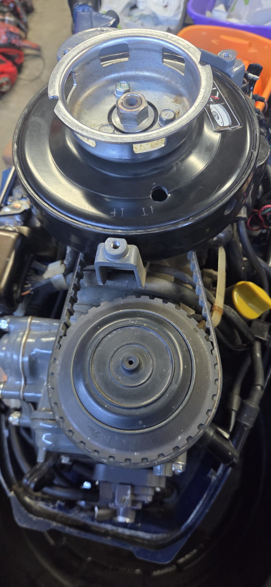

Hello everyone,

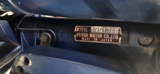

I have a few questions about a Honda B100L outboard that I picked up a few weeks ago. Serial number 1701745, should be a CDI ignition from what I can find. Bought this from a seller locally who said it was on a sailboat he bought. The seller said he had it running a few weeks before I looked at it, but at the time we couldn't get it to start. It would try to fire, but never started. I got it for $200 non running. I'm fairly mechanically inclined and have worked on lots of small engines previous to this. When I got it home I got rid of the old fuel and pulled and cleaned the carb. Ran new fuel lines and fuel filter on the engine and cleaned and gapped the plugs. After all of this I could only get a slight pop out of each cylinder, almost like it was trying to fire later then it should. I should also mention that this thing can be a bear to pull over. With that I checked the compression across the two cylinders and got roughly 150 PSI at both cylinders. I did notice even with the plugs out and turning the flywheel by hand there is a spot when this pistons are near the top of the stroke that its hard to turn. No grinding or anything like that just like it has a lot of compression in that area, but it shouldn't because the plugs are removed. After doing some reading on this site I pulled the carb 4-5 times more to check and re-clean it. I bought a carb off amazon just to rule the carb out and it still doesn't want to start. Just spits and attempts to fire. I'm wondering if the timing could have slipped somehow? Could someone point me in the right direction on the timing procedure or a picture of what should be lined up and where if its timed correctly please. Thank you!
Hi,
In the picture you posted, you can see the pull starter support. Next to the bolt hole there is a stamped line.
To time the valves, bring the top cylinder piston to TDC on compression stroke (valves closed) and the "T" should align with the stamped line next to the bolt hole.
There is either a line or two punch marks on the outer edge of the cam pulley. The line or the gap between the punch "dimples" also needs to align with the mark on the starter case support and with the "T" on the flywheel. In other words, all three marks need to align.with each other.
The "F" mark is an IGNITION timing mark used mostly for the older breaker points adjustment but is also a reference for the CDI system pulsar coil under the cam pulley cover. It shiuldn't need adjustment unless the pulsar coil is being replaced, has come loose or someone has messed around with it. I would definetly take a look in there in this particular case.
When new compression was listed at 151 p.s.i.
Your seeing 150 is odd to me. It makes me wonder if someone may have been "altering" the valve timing to try to raise the compression since a long used engine usually has considerably lower than "as new" compression. Who knows? Maybe I'm just overly suspicicious but have seen much weirdness with diy "repaired" engines. Done some weirdness meself methinks.
I recommend that you check valve lash while you're verifying the timing so you'll be positive that's good.

Thank you very much for the detailed response. I will give that a shot when I get up later today. I'll post back with results. Thank you much for your time and help!

Lined up the timing marks this morning and it was about three teeth off on the cam gear. Slid the belt up and the cam gear lined itself up right on the dimple. Put the belt back on and it fired right up and runs perfect. Now I'm curious to do compression test and see what the numbers show. I still need to adjust the valves, but it will have to sit overnight before I do that. Thanks again for the help, I appreciate it!
