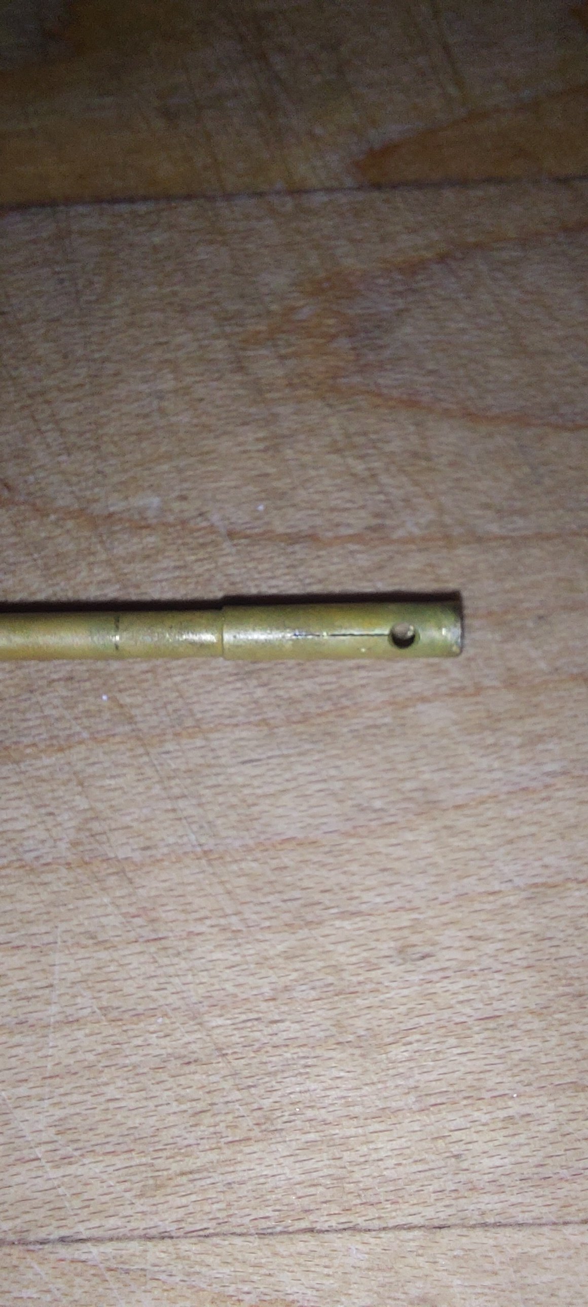

Hi just wanted to give you a update I pulled all the jet sets two are flowing good the bottom one is cracked at the bottom where the main jet is. I'm going to go see about getting one now I'll keep you posted thanks again for the great information oh the bystarter passages are clear sprayed carburetor cleaner everything is flowing thanks
Sorry to bother you again how do I know what one I need or does it matter? My motor is a 2007 25hp Honda four-stroke. Both of these are #40. Confused again lol. Can definitely see the crack on this one.

Hi Jgmo just wanted to check in with you and thank you for the great information it was the jet set it was cracked at the bottom just put a new one this morning and it's back to perfect just need to fine tune the carburetors it's got a hesitation when reving fast. Thanks again. 👍👍
