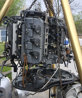

I have a Honda 225 2002. I have an oil leak somewhere above the lower unit. It is coming out where the two 14 mm bolts are that connect the steering arm. It seems to be coming out from where the oil pan is. Any ideas on what to check ?
Thank you, Gary

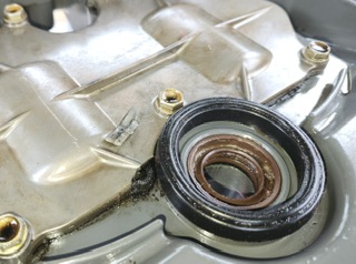

There’s an oil seal at the base of the block that goes bad. Assume it drips when the motor is tilted?
The block need to be pulled to replace the seal unfortunately.

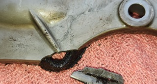

Found the leak! It took me 4.5 hours to get to it. I would like to know what would cause the crack though.
