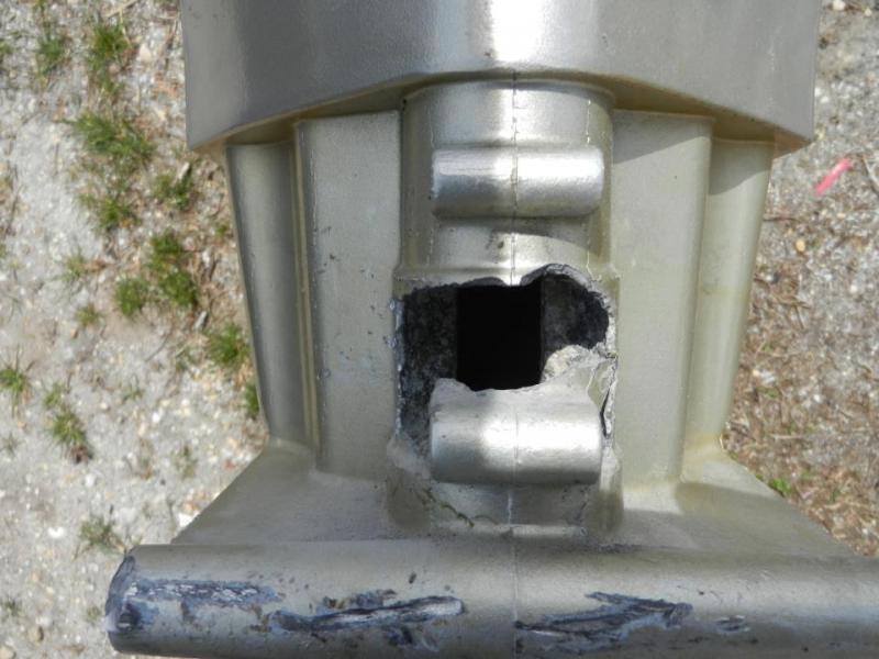

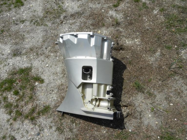

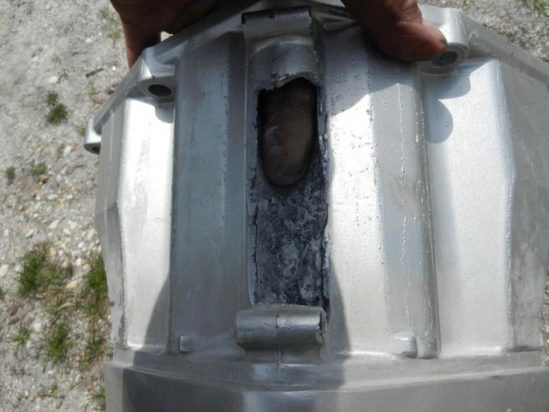

Chris - that's some ugly damage in those pictures! Question for you - are you seeing more problems with the 30" shaft setups, or doesn't the shaft length seem to make a difference?
Based on other posts on this forum, it seems like the only permanent fix for this issue is to install a newer cover that has larger water posts to lubricate the bushing better, as Jamie described in some posts a while ago. Do you agree, or are there other methods for a permanent fix?
Bottom line, in you opinion why does this happen with some of the 200/225 engines, and apparently not other?

I don't think shaft length has much to do with this. I think it has to do more with the quality of the casting. As for the new design helping, only time will tell.
Chris - thanks. At 1500 hours on my 2007 225, I try to stay alert to potential issues. My goal is to get at least 4000 hours out of this engine if the Good Lord allows me to stay around that long.
