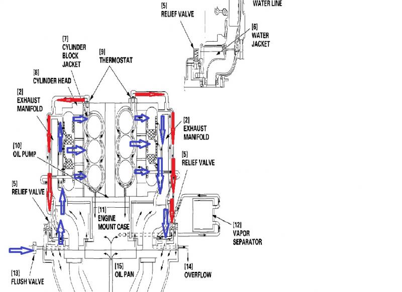

Do you flush your engines regularly? Those blocks do have a weak spot for corrosion and we had two fail at around 1000 hours due to not being flushed often enough. Honda fronted up with two new powerheads under the 5 year warranty, but there was a fair bit of goodwill involved in that decision. Anyway, they didn't even try to suggest that the corrosion was a one off issue and we made a serious change to how often they get flushed after the new powerheads. I like these engines, but compared to some of the other ones we have these need a lot more flusing to prevent corrosion issues.
It is my understanding that using a standard flushing procedure with a garden hose on the 200's and 225's does not get fresh water up into upper part of the engine around the t-stats. I've never checked that, but will try to determine if it does the next time I pull the boat.
Flush water is in blue.
Personally, I do flush the engine after every use whenever I can, but sometimes I need to park it overnight at a neighbor's pier because I can't get on my own lift due to low tides.
The corrosion we had wasn't at the thermostats. it was on the rear of the engine and part way down the block. Same on both engines and I am pretty sure that it wasn't unique to us. You raise a good point though and I need to try and work out whether the flush port gets into that area. Boat lives on the water, but we could still use muffs and fresh water to flush it if the flush port doesn't reach those areas.
