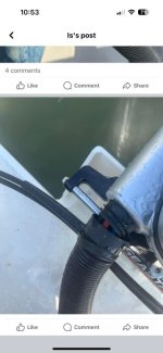

1) Last year he had to replace the shift cables and engine harnesses due to seawater getting into the rigging tubes and corroding them. Tubes still won’t seem to stay attached on the motor side. Thoughts?

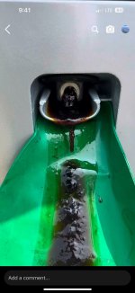

2) dealer changed oil last year and was gelled in both motors. Like jello that my kids mushed a spoon through. Huh. Never heard of modern motors and oil gelling. Thoughts?

Attaching pics of loose rigging tubes, gelled oil, and coil embedded in the cowling. And my twin 8 yo sons enjoying the sea trial w an iPad 😞😂

1. Drill drain holes in the rigging tubes.
2. Jellied oil? Never heard of that happening. Either someone put in the wrong oil or it got badly contaminated somehow. Recommend that you use Merc 25W-40 FC-W replacement oil.

I'm told there is a revised screw in rigging from honda from later motors- so I would retrofit these if I buy the boat to avoid another rigging corrosion issue.
