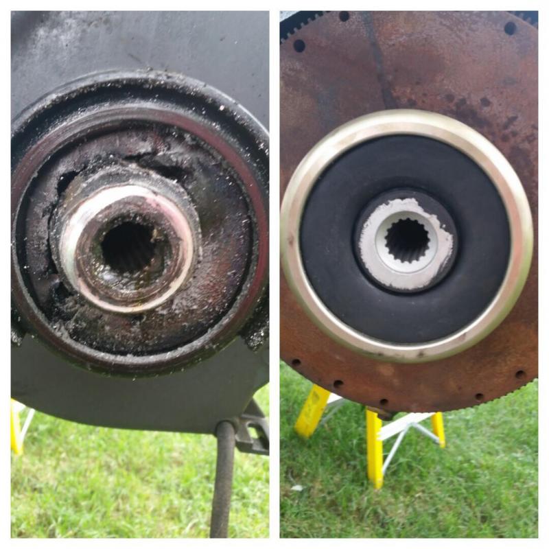

Hello, I'm very new to boats, and just purchased an 88 bayliner Capri. When I bought it I was told the gimble bearing was bad. I have it removed and the bearing itself seems to be cocked at an angle inside the inner race is this normal? Also there seems to be about 1/8 inch gap between the bottom of the boat and the out drive is is also normal. Thanks in advance

motor is now out of the boat, out drive is separated from stern, and new problems have popped up!
Engine coupler was bad , and has been replaced. Have new gimble bearing to install when outdrive is reinstalled
transom has ROTT! And motor mounts (front) don't seem to tighten all the way up the actually can pivot about a quarter inch left and right on front holes( which are slotted) but loose lag bolts lets the pivot, and they don't tighten all the way!Thinking that's why it destroyed the engine coupler and and gimble bearing! I can fix that , but I don't know how to fix the transom or motor mount issues. At this point I'm ready to pull my hair out! Need ideas to help me get started in right direction any help would be great , thanks
