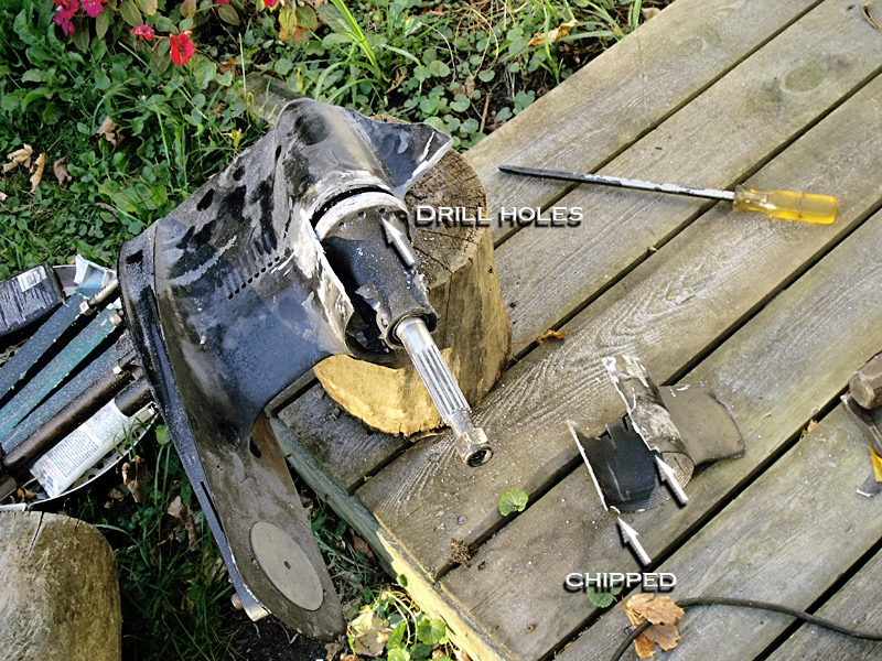

From what I can find they only came in 20" shafts. Your LU should have a stainless steel driveshaft around the water pump area which makes it desirable the '74 probably has carbon steel which is less desirable; if you want to get the bearing carrier out I would say to soak the exhaust area with a penetrating solution for a few weeks, it is possibly "welded by corrosion" in place I had that problem and see the results.... trashed-LU.jpg
