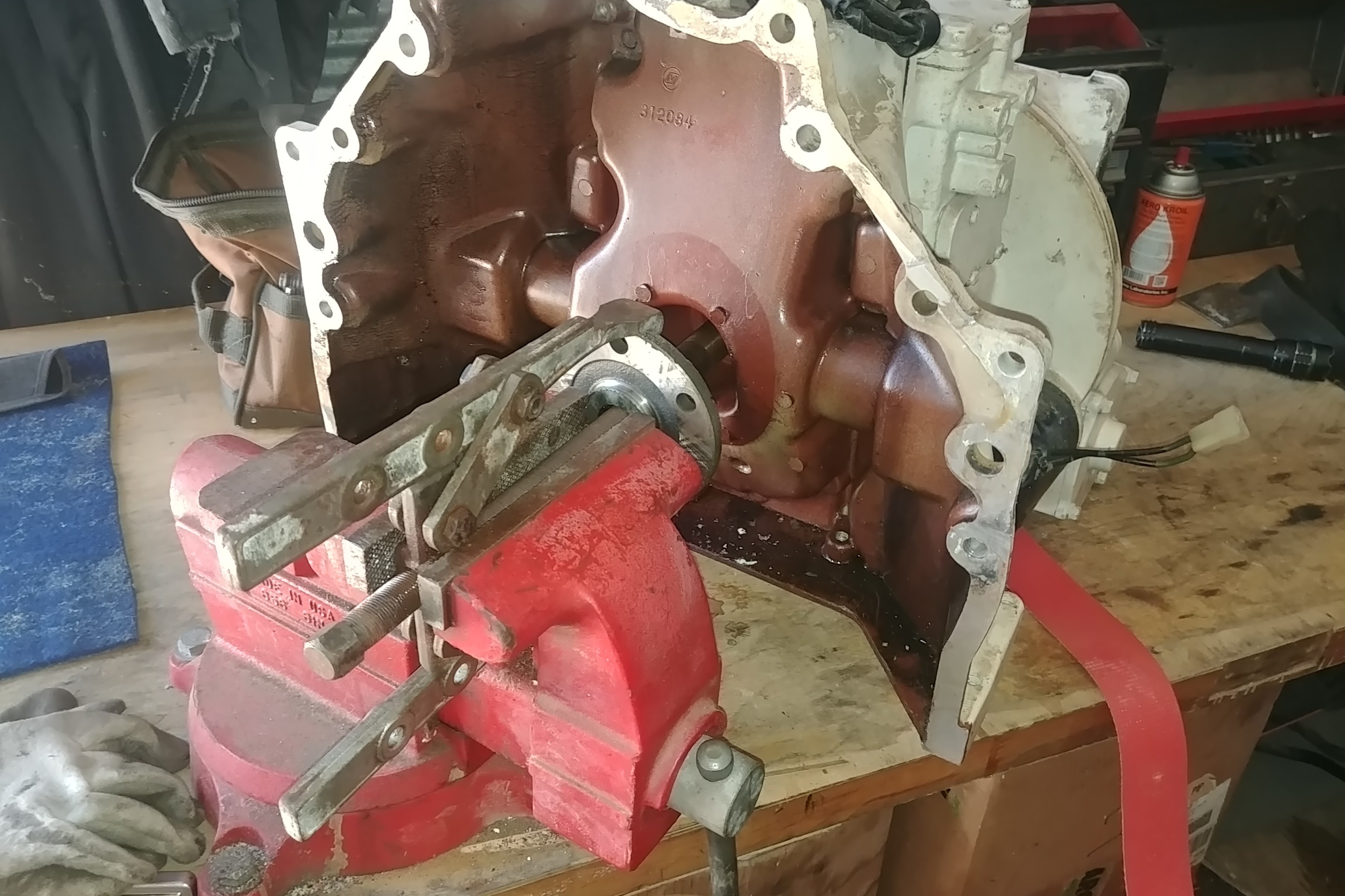

FYI, here is why I said try.....
Old 120hp intermediate would not separate from engine. Splines stuck like glue.
Had to remove bottom access panel from intermediate. Working thru the limited access with a deep offset wrench (5/8 or maybe 11/16, can't remember) I was able to remove the 6 bolts securing the coupler to flywheel (actually they hold flywheel on too) slowly, like 1/6th turn at a time. Then removed the assembly with stuck on coupler. Required a gear puller to free coupler. Cleaned splines, they were actually good. Reinstalled coupler to flywheel. Lubed splines with Molylube & reattached intermediate.
