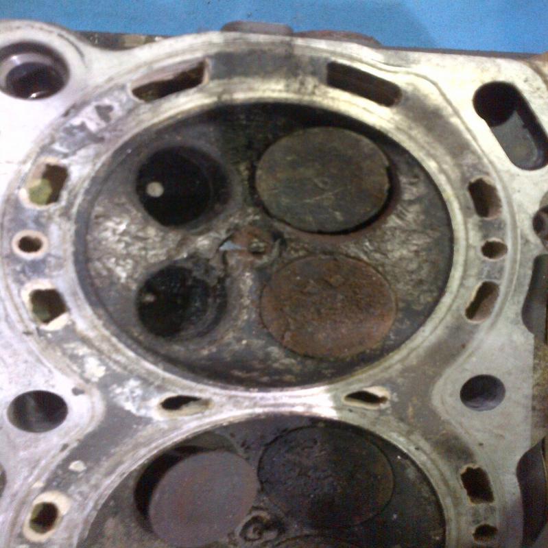

What cylinder has the broken valve? Was there corrosion on that cylinder only, or was it on all of them?

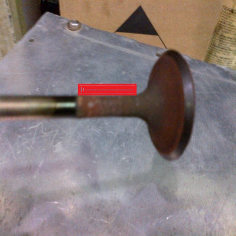

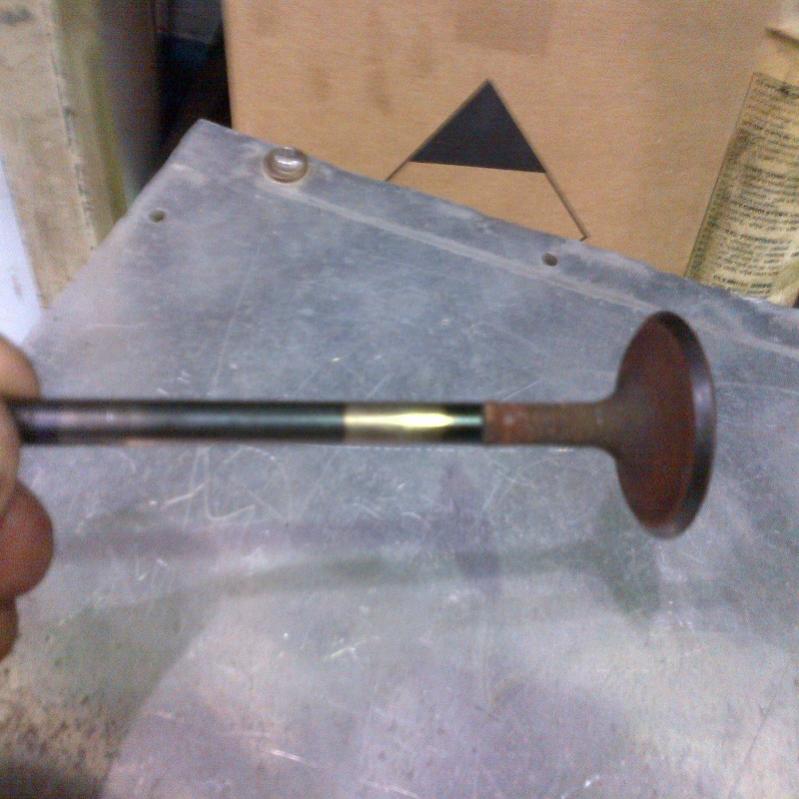

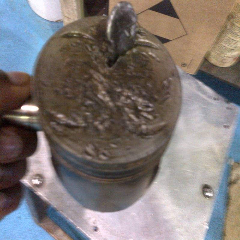

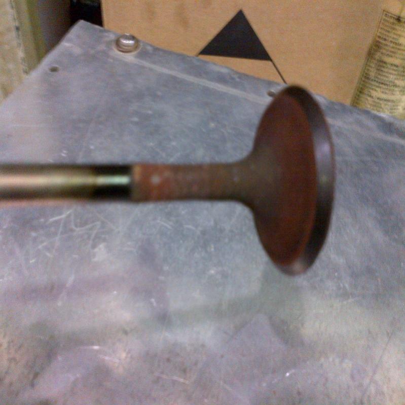

2.jpg5.jpg01.jpg4.jpg they are some of damage parts, exhaust valve from other cylinder,we had case of No1 cylinder No2 cylinder and No 6 cylinder, this photos from recent case those valves are not much corrode but before some engines exhaust valve are badly corroded and the place i marked that place thickness become less.

That "necking down" is, at least to me, evidence of heat overload and the valve stem weakening. The rust may be indicative of something else undesirable happening in your engine. Since the exhaust is water cooled, there could be excessive backpressure taking place and forcing coolant water back up the manifold and on to the back side of the valve. This could cause a "thermal shock" condition that would further weaken the valve and cause it to fail suddenly.

I am sure piston is hit the valve, but how its happened. Valve clearance,valve guide,old valve springs.
valves are broken but when i opened still remaining valve stems and valve springs are their.if you can see in the photos half of the valve stems are their. No over heat mark,burn mark on that, looks like its bend and broke.
