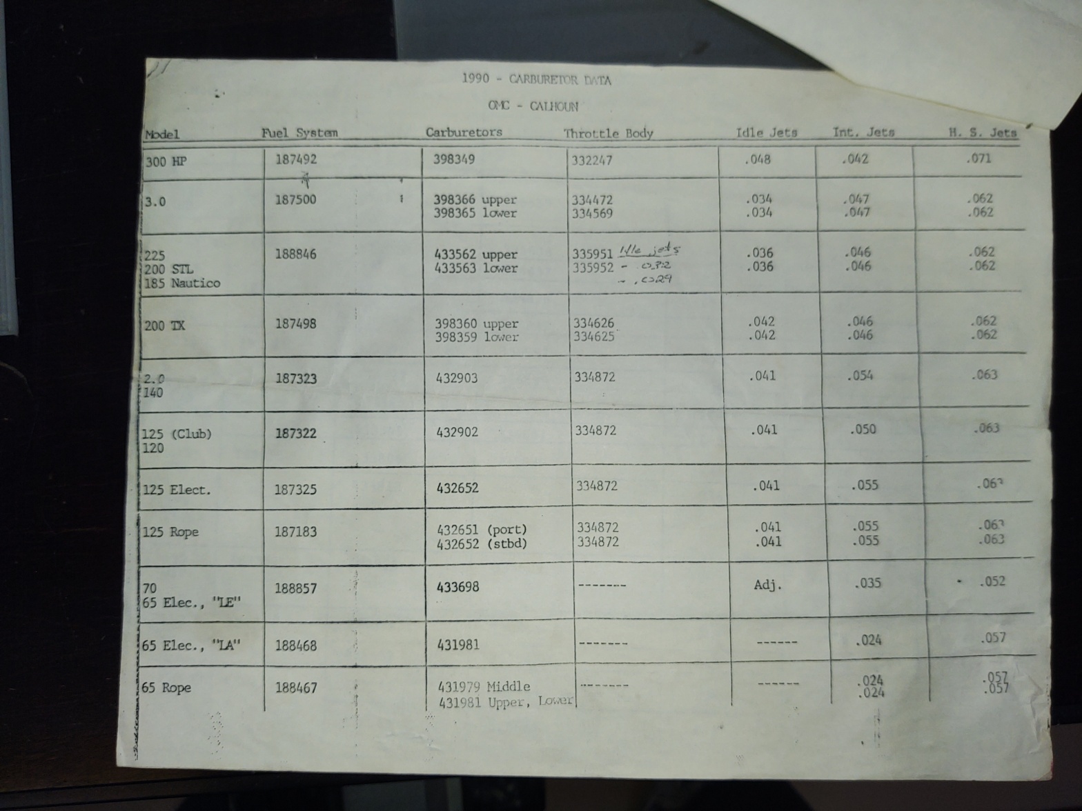

i recently purchased an older evinrude engine. The serial on the tilt trim bracket, is E140TLESE. which comes up as a 1990, 140hp. however the power head on my engine does not have the coolant cross over tube, which means its a 92-94? a fellow boater told me who looked at it. Id like to try to identify what year the power head may be so i can order parts as well as a service manual. when i purchased the engine it as it still does, fired right up. did a compression test and numbers were 125 on all 4 cylinders. so i loaded her up and was on my way, i now have her painted black, and rigged up onto my 1971 16' Tahiti.

i did ohms tests and dva readings on all the electronics and there are a couple things in question but nothing that seems like the electronics have failed. although they could be original? i am going to attach some pictures as well as a link to a youtube video of it running with the sneeze or misfire taking place, the video is a lil blurred i dont know why on my phone it is crystal clear...
