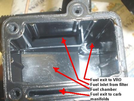

I tried to find a fuel flow diagram for your engine and still wonder what fills the vapor separator float bowl with fuel? It looks like the VRO pulls fuel from the bottom of the vapor separator and other diagrams show a lift pump but by the sounds of it it is just not able to keep up with the demand at WOT. Racer would know how the system works. Maybe a vacuum guage for the fuel supply will tell you if it is losing suction pressure at higher RPMs?
Are you sure about that
110%...That float has 100% nothing to due with any fuel entering or leaving vapor separator. What diagrams are you looking at that show a ilft pump????? Thought you own a 60 degree????
I just typed in my model number in on evinrude website and it shows a vapor seperator pump.. idk my stuff lol that's why I'm on here ��
Yes it has a vapor pump and it does nothing but vapor.... Here are pic from one of my old post where I broke down the fuel bracket and labeled passages and flow.

Well there ya go then... guess the next question is if my fuel pump actually can't supply enough fuel for the motor at full throttle, or what the heck could be causing this. Cause it's not all the time it does this. I recorded for 7 minutes straight at full throttle, it didn't do it. Slowed down some, decided I give it one more shot before I got to the ramp, as you saw, within about 8-10 seconds it acted up. When the motor slowed down I didn't touch the throttle at all til the motor hit minimal planing speed. Then I pulled back all the way to idle speed, and within 10 seconds I trimmed it down all the way and went back on plane and hit full throttle and it didn't act up again.. like what in the world could intermittently cause this. I know it's Something on the motor since it acted up the same way on a good known portable gas tank..
