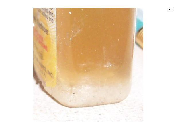

Here's what happens when ethanol gas is allowed to sit for (two years in this case) in a vented tank. The white 'gook' you see at the bottom of the bottle will not burn, yet it passes freely through filters, including a water separator.
Jeff
