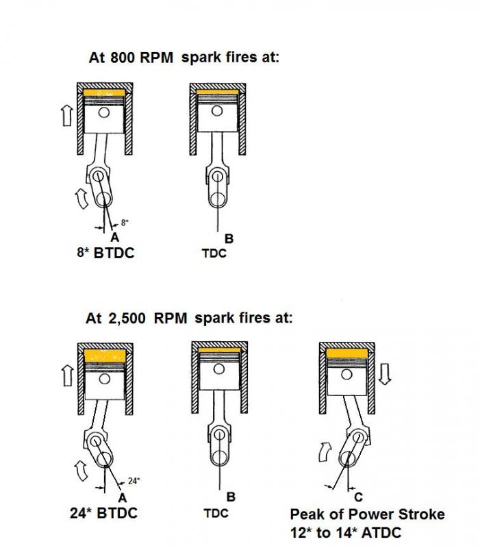

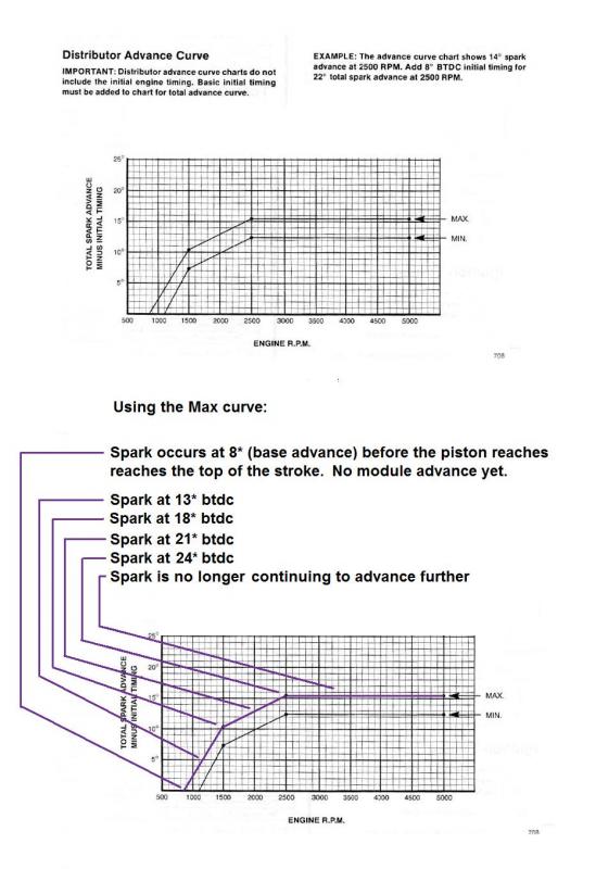

correct ignition system spark advance ..... not only during BASE mode, but throughout the RPM range
I'd strongly suggest that you find your OEM ignition advance curve (per your engine serial number), and compare your actual spark advance (the number of degrees that you see per RPM throughout the range), to the Mercruiser curve graph.
Understand the ignition advance numbers being thrown at you here are absolutely meaningless unless accompanied with an associated engine RPM!
IOW..... I could tell you that your total advance is to be 28°.....… but unless I include the RPM where you will see this 28°, it will be absolutely meaningless to you...... and perhaps even dangerous!!!!

IMPORTANT: The graph below shows the typical advance ranges for a Thunderbolt
V ignition control module. The numbers plotted on the graph are not representative
of any particular model. It is only presented to provide an understanding of how the
system functions.
Based on the timing graph in the manual with a base timing of 0 you should reach max timing 25 degrees before top dead center +/- 10 degrees by 1800 rpms.
The + is (Acceleration advance range) and ( MTB mean best timing)
The - would be (knock control spark range) meaning if a knock is sensed by the knock sensor the timing will retard up to 10 degrees or so.
so if base is set to 8 BTDC then max should be 33 btdc at or by 1800 rpms if no knock is detected.
= Base Timing Advance Curve
= Idle Speed Advance Range
= Knock Retard Range
= Acceleration Advance Range
= MBT Advance Range
It says there that the ignition module may supply more spark advance. But in my circumstance isn't it my ecm that controls my spark advance? So if my ecm isn't working or working properly it's not going to adjust for the spark advance.

Agreed. I cannot really find out what my full throttle timing is.
We're not after full throttle ignition timing!
You'll want to be looking at the progressive advance, and the advance at the prescribed "full-in" RPM.
The correct ignition advance curve graph will show you this.
But the engine is timed to 8* in base timing as it should be.
Yes..... but this does not guarantee that the module is offering the correct progressive and/or TA.

And this is exactly why I have been suggesting that you look at the progressive ignition advance..... and at the Full-In total advance.... and the RPM where this Full-In advance occurs!
Then compare your numbers to that of the OEM specs!
NOTE: the following is an example only...... see your OEM specs as per your engine model.

MCM V-6 262 CID (4.3L) with Thunderbolt IV
The vertical colum to the left represents the ignition advance provided by the module.
NOTE: "BASE" or "Initial" advance are not included in the vertical scale.
The horizontal scale represents engine RPM.
The line graph will show you where the spark lead is at an array of RPM.
Note the increase in ignition advance from the low RPM BASE mode! This is the progressive advance.
A progressive advance is necessary because the fuel/air mixture does not combust instantaneously. It requires a "lead" as the rotating assembly's speed increases....... I.E., an advance! This advance must correlate wtih engine RPM.
Note that the increase in progressive advance levels off at about 2,500 rpm. At 2,500 rpm, the advance is "full-in".
Using this graph..... and if we add a BASE or Initial advance of 8* to the module's advance of 14*, the advance that the engine sees @ 2,500 rpm is only 22*! A far cry from 30*!!!!
As you can see, if you were to change the BASE of 8* to 10*, the progressive and TA will also change by that same 2*.
Again... the above PDF file is an example only!

Example... and according to the example graph that I posted:
At 2,500 rpm, the piston must be at or near 24* before top dead center when the spark fires.
Conversely, while at only 800 rpm, the piston will be @ 8* before top dead center when the spark fires.
If you threw 24* at it at 800 rpm, the spark would fire too early, and would tend to push the piston down in the reverse direction.
Correct spark timing is extremely critical for the Marine gasoline engine.
Not enough, and/or too late..... and we leave power on the table.
Too much, and/or too early..... and we risk detonation damage.
No offense to you..... but if this is over your head, you'll want to have a pro do this for you.
