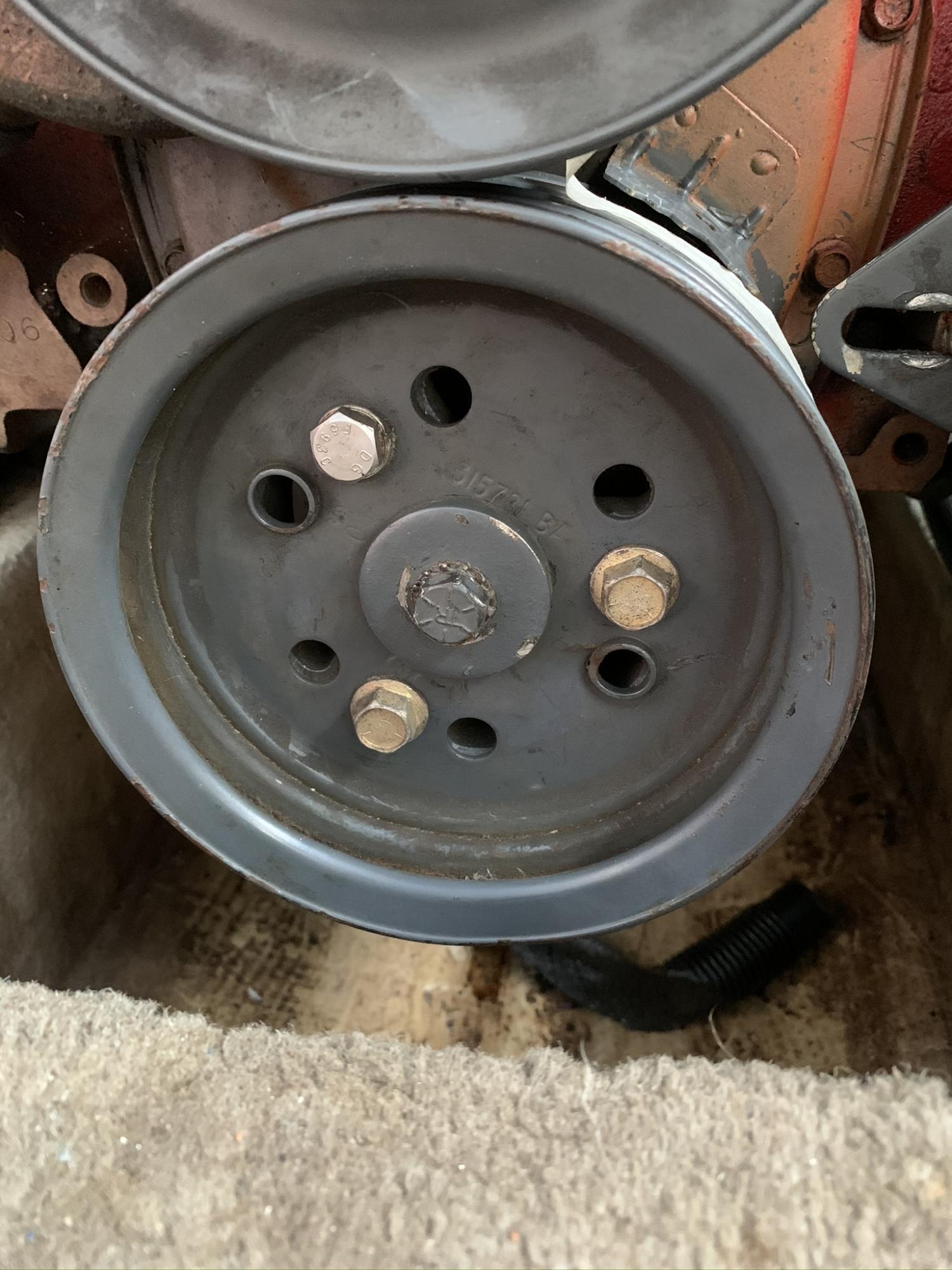

Interesting you say that, because it is the peace of mind I want when on the water. Its my relief valve and I have to be worrying about the boat when I'm trying to enjoy the sunset. Definitely worth my time. I found the post very helpful and am slowly piecing it all together. There really are no mysteries are there. Just process of elimination... I've attached my OEM timing curve I normally cruise between 2500 and 3000 and get up to 3500, rarely go WOT but like to every now and then. :)mad:trying to post my engine timing specs,I find this site frustrating when trying to post pics. Sometimes works like a charm and sometimes it appears to upload and nothing happens. Not sure if it my machine or the ME site.)

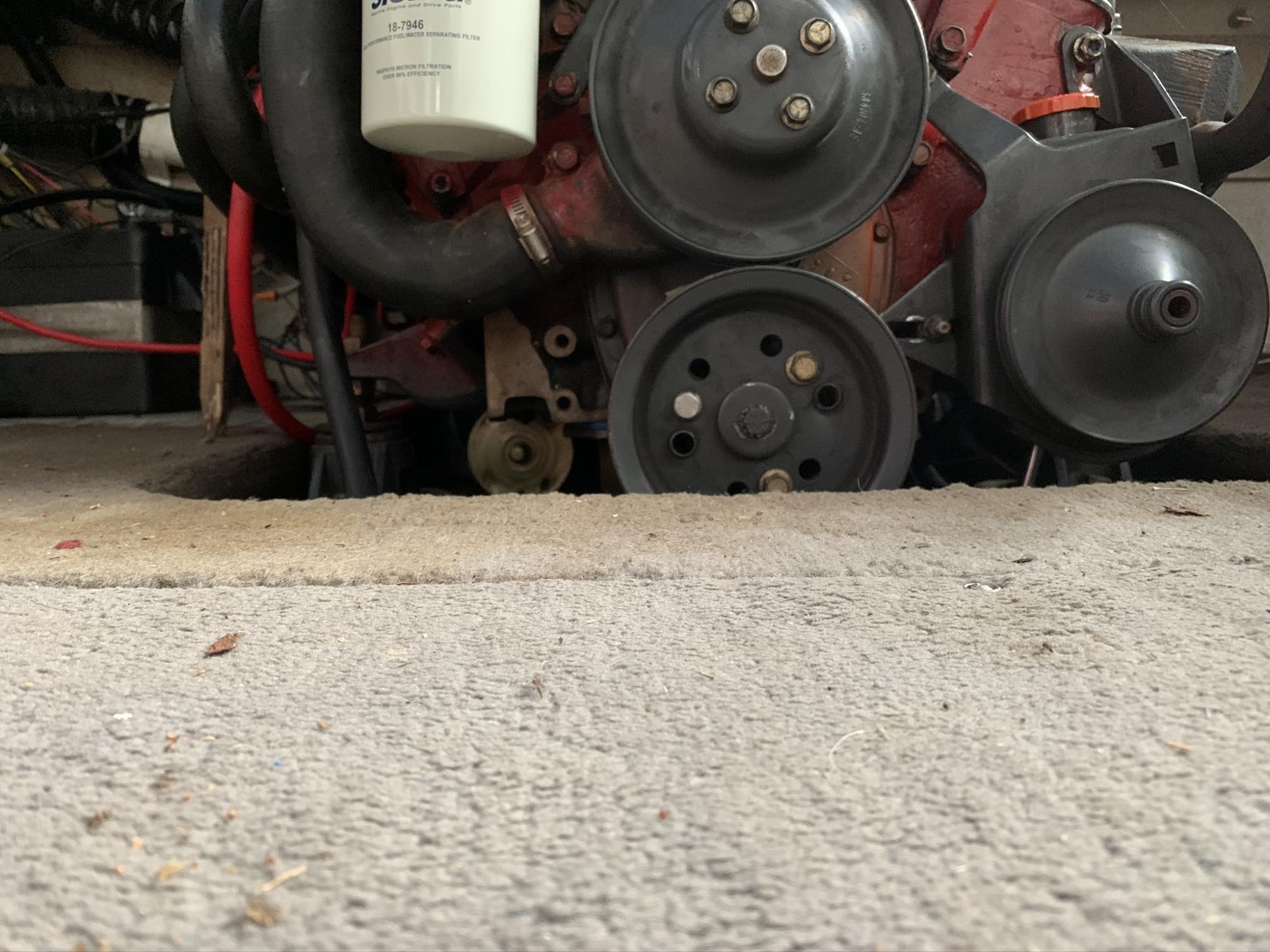

So, some more first timer questions about removing belt pulleys, installing the degree wheel and replacing pulleys.
  1. Does anything else need to come off first before adding degree wheel to accommodate a 14" wheel that I'm planning to get from a speed shop or online. I measured below the deck to insure no obstruction of the wheel but I didnt think about the power steering pump or water pump.
  2. How do I keep engine from turning when removing center bolt holding the pulley to the balancer? Then same when removing wheel and reinstalling pulleys?
  3. The degree wheel will bolt to balancer, using same bolt that held pulley, correct? I assume it comes with a washed to take the space of the pulley.
  4. Once degree wheel is on balancer, do I rotate the TDC mark on balancer to 30 degrees before or after as a starting point to insert the Positive stop?
  5. Does it matter how far into the the cylinder the stop is adjusted?
  6. Any other tips or gotchas I may run into while performing this? , For example, should ?I expect the pulleys to slip off fairly easy or is a puller required? I always seem to be the guy that does not have what I need when I need it and it sucks any working efficiency right out of the job to be done. Any tips that reduce my "discovery process" are always appreciated.
1... Does anything else need to come off first before adding degree wheel to accommodate a 14" wheel that I'm planning to get from a speed shop or online. I measured below the deck to insure no obstruction of the wheel but I didnt think about the power steering pump or water pump.
A 14" diameter degree wheel will have a 7" radius. Do you have enough room for a radius that large?
2....How do I keep engine from turning when removing center bolt holding the pulley to the balancer? Then same when removing wheel and reinstalling pulleys?
Be creative.
3..... The degree wheel will bolt to balancer, using same bolt that held pulley, correct? I assume it comes with a washed to take the space of the pulley. The crankshaft pulley is held in place with 3 bolts and the center crankshaft bolt. The degree wheel will have one hole only.
You will be using the center crankshaft bolt for the degree wheel.
4.... Once degree wheel is on balancer, do I rotate the TDC mark on balancer to 30 degrees before or after as a starting point to insert the Positive stop?
The depth adjustment of the PPS will determine the amount of degrees that the piston is short of reaching TDC.
In other words, the more that you extend the PPS into the cylinder, the greater the degrees between your CW and CCW rotational stops.
The goal would be 25 to 30 degrees in either direction.
This equates to more accuracy.
5.... Does it matter how far into the the cylinder the stop is adjusted?
Yes... see above.
6.... Any other tips or gotchas I may run into while performing this? , For example, should ?I expect the pulleys to slip off fairly easy or is a puller required? I always seem to be the guy that does not have what I need when I need it and it sucks any working efficiency right out of the job to be done. Any tips that reduce my "discovery process" are always appreciated.

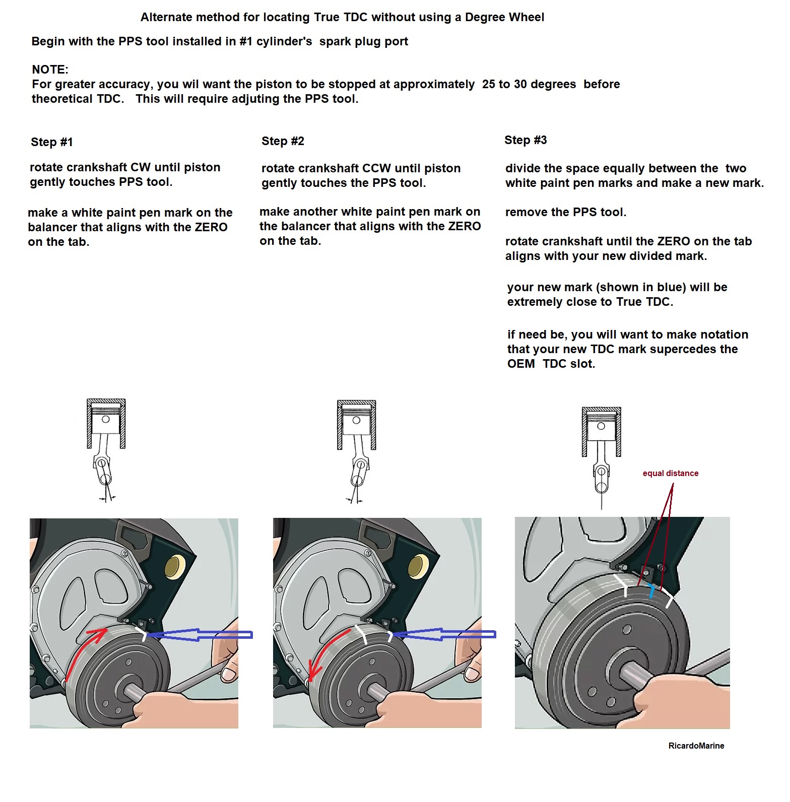

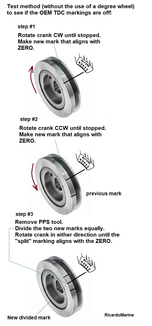

Since I believe that you are not quite understanding this (no offense), I have a suggestion for you:
Forget the use of the degree wheel and temporary pointer.
Instead, use the circumference of the harmonic balancer against the timing tab ZERO.
(see my image below)
Doing so will at least allow you to verify the accuracy (or inaccuracy) of the OEM TDC slot in the harmonic balancer.
If you see a discrepancy (due to the outer ring having slipped on the inner hub), your new paint pen TDC mark will take precedence over the OEM TDC slot.
If you do see a discrepancy, it will mean that the inner/outer hubs have slipped on one another.
If so, take a punch and mark each hub.
If after hours of running the punch marks do not remain aligned, it will mean that the hubs are still slipping

I just found another image that I had made several years ago that I had forgotten about.

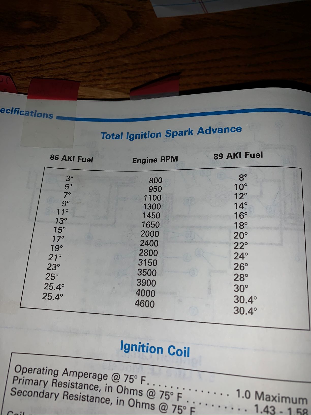

I looked in my OMC shop manual from 1988 which is older than yours but, for the 5.7 King Cobra they gave:
8* base timing + 21* full centrifugal advance @ 3,000 rpm, for a total of 29*. If you can set it up with the 8* at idle and then use an advance timing light to check full centrifugal advance with it in the water (I prefer not to rev that high on the water hose, but if you have very good water pressure and good muffs you probably can) you will be close enough.
Thanks Lou, petty close to mine. I found this in my manual. So I take from this that he original ignition (Prestolite) would create this spark advance pictured below. If just occurred to me that, if it is the ignition system that provides the spark advance, then shouldn't I be able to get a similar table from Pertronix for a SBC? I understand that all of this is predicated on the fact that I have an accurate TDC mark on my balancer. I'll be checking on that my next time out when I install the new marine starter.
Yes, and I do have the boat on a lift so i can get it in the water. So revving the motor is not an issue.
attachment.php
Yes.... absolutely!

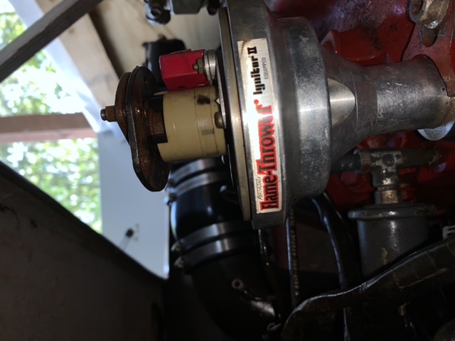

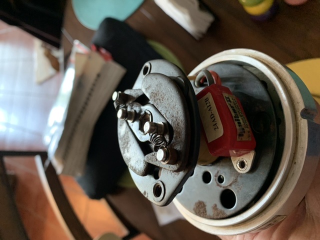

This image is from post #10. This is your distributor, correct?
attachment.php
Those springs shown are connected to the centrifugal weights. These provide the advance as the rotation speed increases. Each of these weights needs to be able to slide outward at the end furthest from the spring. Do they slide freely and return to the position shown when released?
Sorry, missed this. Yes this I my distributor and I cleaned all the rust and they operate freely now.
But the real question is do I use the Advance/RPM values In my OMC manual which shows Prestolite ignition. The distributor above is Pertronix.
Short of any EST system......., whether Prestolite, Mallory, Pertronix, Accel, MSD or other, the triggering mechanism (contact points, VR, photo-eye or Hall Effect) has ZERO to do with the mechanical advance.
The triggering portion creates coil saturation and the collapse of the field that produces the high tension voltage.
The mechanical advancing mechanism creates the curve and will determine when the system is Full In.

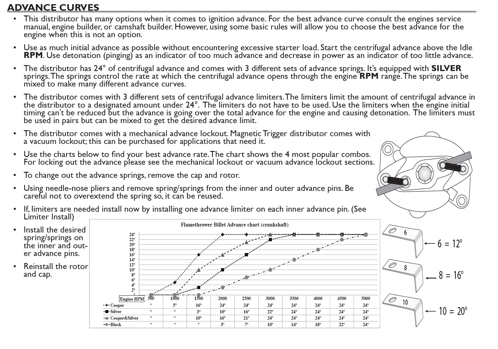

Pertronix got back to me with an attachment, I tried to upload but unsuccessful so I pasted of couple screenshots. If you know why let me know, the file size is 1.2MB. Maybe file is too large...
With the silver springs, the distributor offers ~23 degree advance (estimating from chart) at 3200 RPM. Adding to a base of 8 degrees, that should result in total timing of 31 degrees BTDC total timing 3200 RPM.
I found another nugget in the Pertronix documentation that would seem to open another can of worms. I'd rather not explore it but for the sake of education and full disclosure, I'd like your thoughts. I did replaced my ESA module a couple years ago. The symptom at the time was the engine would start sputtering and cutting out at higher RPM, I don't recall the brand, I may have even posted on this forum. Anyway, my boat has never had the diodes or resistors per the Pertronix instructions.
Pertronix offers wiring specifically for OMC Sterndrives using diodes and resistors. I'm not going to bother with the diodes and resistors until I confirm my TDC mark and observe the total advance at 3200 to 3500 RPM. I'm unsure if the OMC wiring if for Pertronix Coils specifically or for all coils. I have a reply into Pertronix asking for clarification.
Do I adjust the distributor until I get the desired total timing at a specific RPM?
  • I follow the Pertronix chart below, the advance at 3200 RPM is maybe 23 degrees? Adding base timing of 8 degrees for a total of ~31 degree Total Advance @ 3200 RPM.
  • The OMC Manual shows advance of ~26 degrees @3130 RPM, Adding base timing 8 degrees for a 34 degree Total advance at 3130.
I am more inclined to use the Pertronix data since that is the distributor that I have.
Hypothetical:Assuming I use Pertronix values, is the action correct?
  • Observed a timing at 3200 RPM is 34 degrees BTDC.
  • Action: Retard Timing at 3200 to 31 degrees.
  • If I retard timing at 3200, I assume timing will also be retarded at idle.
with your math, those numbers would appear to be correct.
However, with a build using what are most likely the GM Full Dished pistons, I would cut this back to 28/29 degrees @ 3,200 RPM.
The fuel quality (octane rating) will influence this also.
I would never swap springs under the guise that each spring kit offers a curve of a certain value.
As well intended as the company may be, the governing spring values may not be consistent.
This is where the Sun, Allen or King machine comes into play..... or, you do an "On Engine" test and plot the curve out on graph paper.
Any needed change would require tweaking of the spring supports.

  • I follow the Pertronix chart below, the advance at 3200 RPM is maybe 23 degrees? Adding base timing of 8 degrees for a total of ~31 degree Total Advance @ 3200 RPM. Like said, I would cut this back to 28/29 @ 3,200 RPM.
  • The OMC Manual shows advance of ~26 degrees @3130 RPM, Adding base timing 8 degrees for a 34 degree Total advance at 3130. I guess you could roll the dice!
  • Observed a timing at 3200 RPM is 34 degrees BTDC. In my opinion......... unless your engine was built with a Q/E combustion chamber and used with high octane fuel, that would be excessive!
  • Action: Retard Timing at 3200 to 31 degrees. Perhaps still a bit excessive!
  • If I retard timing at 3200, I assume timing will also be retarded at idle. Correct. As noted above, with a mechanically advancing system, any change to BASE advance creates an equal change to the TA, and visa-versa.

I understand. I noted the following in the Pertronix documentation. This would be the methods to "shorten the rope" I presume. I will check it out and keep my fingers cross that I 8-29 degree range with not modification. I would have to order parts and instructions from Pertronix.
What do you think about the second bullet below? I would not know how much more initial timing to use. Sounds like the more base advance the more load on the starter so is too much advance indicated if engine barely turns over. Seems arbitrary but I guess I figure it out. I'll be conservative with distributor movement.

My comment was related to the second bullet of the Pertronix instructions which indicates to use as much initial timing as possible without excessive starter load. It looks like my screen shot of he Pertronix instructions did not load. I'm just insuring I understand the process. I don't know what action I'll need regarding timing advance until I can accurately read the total timing at RPM. But, now I have a much better feel for the process.
The Pertronix bullet point #2 was apparently written by a person with no Marine Engine experience or knowledge.
In my opinion, bullet point #3 should be executed while using a distributor machine.
As per bullet point #4, if you were to use the copper (not "cooper") springs, and if they indeed created that curve shown (plus BASE advance), you will damage your engine.
If you were to use the black springs, and if they indeed created the curve shown, your engine will not produce any power.
Bullet point #5 mentions vacuum lock out. Vacuum advance is NOT used on the Marine Engine. The mere mention of that leads me to believe that the instructions are very generic, or even automotive related.
I had to google a Sun machine.:D Looks old school. Not even sure where I'd find one in Dallas. I assume hot rod shops are the few folks that work on distributors these days. Hopefully I will not need one.
Yes, the Sun, Allen or King machines are "old school", but are invaluable for people like yourself with a mechanically advancing ignition system..... especially when it comes to changing flyweight governing springs and/or limit stops.
Please understand that your SBC engine build (piston profile, combustion chamber volume, camshaft profile, fuel octane rating, etc.), along with the anticipated Marine Engine Loads, are all part of what determines the ultimate ignition advance curve........... NOT the distributor nor the make of the distributor!
The second sentence in Bullet point #1 is the best advice that Pertronix has offered.

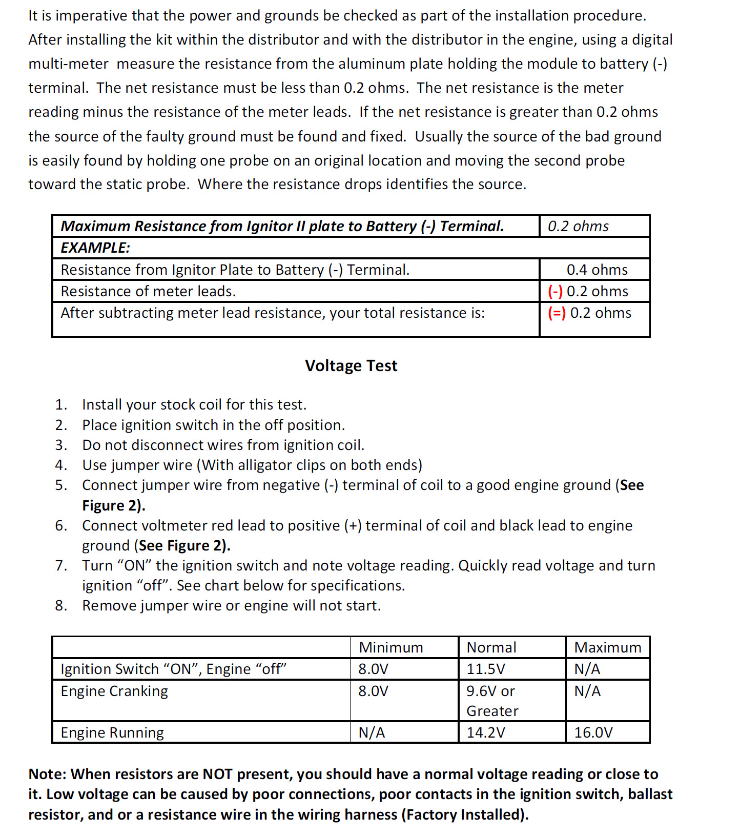

Interesting comments on Pertronix. I’ve thought multiple times that perhaps problem is in ignition. But I’ve done test per their procedures and it falls within spec. I’ve tested resistance for the ground which they told me is most common issue. They say it can’t be more than 0.2 ohms, mine is 0.2.
I also checked voltage at coil positive with key on not running and it is in the spec they gave me. Minimum voltage at coil + should be Minimum 8 VDC key on. Mine was over 10 VDC but less that the 11.5 VDC normal Although it was below the normal for their spec it was above minimum. I was not confident checking the coil while cranking or running because the negative of the coil was grounded to engine as was the positive side of the coil as per their attached instructions. Pasted below.

I was able to determine that my original timing mark was within 2.5 degrees of original, My method could be within the range of error. I printed off a degree wheel and stuck it to my balancer and used PPS.
See posts #33 and #37 again.
Use that method that rid yourself of the 2.5 degree discrepancy.
Ignition timing is based on crankshaft angle.
A 2.5 degree TDC mark error at the crankshaft will be a 2.5 error with regard to the ignition timing.
The - side of the coil is only taking to Negative during coil saturation (once per cylinder firing).
When that circuit is released (again, once per cylinder firing), that is when the high voltage discharges.

I went out this morning to look at it again. This time I saw more stable marks with the strobe and was able to adjust down to ~8 degrees BTDC. When throttling up to ~3200 RPM I observed TA of around 34-36. I am using the original timing mark if I did make a mistake with the 2.5 degrees then that can be taken into account. Either way, that is way to high. I also note that when I tighten the distributor, the timing always advances a few degrees.
When I retard down to 8 BTDC I feel a subtle bump on the distributor. This makes me very nervous so I left it at about 10 degrees BTDC
I called mechanic and he is pointing be back to fuel pressure as source of the miss and the fact that the brand new plugs fouled with carbon after a day of very little run time on the lift while I was experimenting with the timing. I'd like to test the fuel pressure under load assuming I can get it to run on the water. What would you recommend.
Trying to eliminate all non issues prior to having the mechanic come out.
I cannot emphasize enough the importance of locating true TDC. That would be my first priority.
