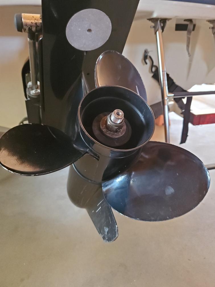

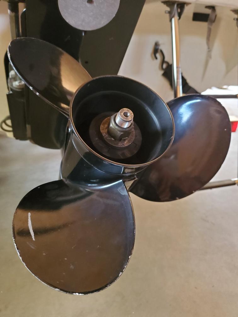

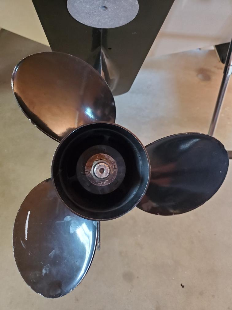

Take a good clear picture of your propeller and post it.
