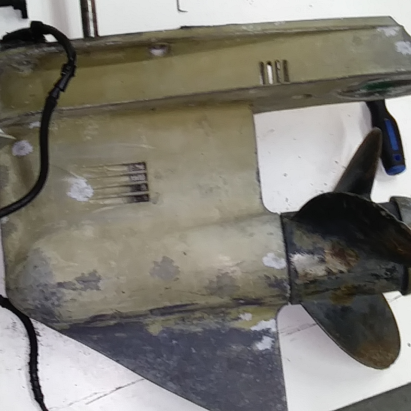

The 2 lower units are different. The water intake on one has slots and the other has round holes. (I couldn't upload a pic)
They also have different water pumps. Are these lower units correct for my 2 engines or is one from a previous model year?

Lower units. I have no idea why the pictures flipped upside down.
Left is long shaft and right is shorty.

The unit with the round holes is a newer replacement.----The plastic pump housing is a newer replacement kit.----The ruined impeller ( plastic housing ) is due to it running DRY.----Still done today as folks simply do not know it is a mistake.----The 72 models only use ONE copper tube for water supply to the powerhead.

regarding the lower unit.
Yes, a V-4 lower unit seems unlikely. A newer replacement? Wasn't 72 the last year? Do you know if there are significant differences between an original and newer replacement? Other than the shape of the water holes? They look identical otherwise.

???----Well ---1972 was the last year they were produced / marketed.----And I know that all too well !----Spare parts were available and the lower unit might have been installed in 1980 !----I would have to see your motors first hand on your other questions.----The 1972 models used 1 water tube ( not a suction tube ) and perhaps someone made a mistake.--Installed parts from say a 1968 model 3 cylinder 55 HP.------For some folks everything / all parts are the same.-----The 55 HP models has just 2 intake ports.-----The 60 HP models had 3 intake ports.----But I would need some tokens for the " in & out " store as blisters on my typing fingers hurt.
