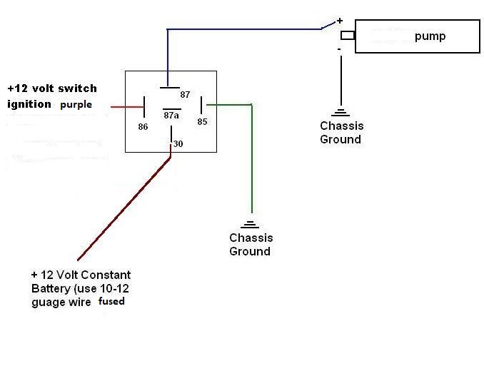

is there anyway i can wire the electric fuel pump to the key switch. some times it will come on and sometimes want. left me stranded today. serial number is OG498832. This is the fuel pump in the vst
Before you do this make sure it not a harness or pin connection on pump problem...Make sure ECU harness is tight, fuses in fuse holders female end is not burnt or melted, and connection to pump are not broken. You can use a power trim relay but will tell you how after you test the above.

ok it quit on me today. i did test light test like you said to do but it did not matter how i hooked up test light while cranking, the test light always stayed on. I then used jumper wire from ground on engine to -post on pump, pump came on and engine would crank and run fine until i took jumper wire off -post on pump. I did this 3 times to make sure. Does this sound like driver board in ecu is bad, if so what can i do with the trim relay. thank you sir
Only use a trim relay as they are sealed..
