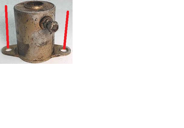

Very easy fix DJ...The solenoid base is grounded thru the cowling support..just like your starter as it has no built in ground wire. Those solenoids get weak over time due to heat from setting in sun over the years. Make sure plunger is not rubbing on any wires and if free ...remove solenoid, add 2 thin 1/4-20 S/S washers under the solenoid base (red lines) to shim it down and reinstall. Gives magnet field more area to grab on plunger..
Now THAT'S the answer about the ground & wire I was looking for. Thank you, sir. Makes perfect sense. The motor is my winter project and was sitting for years in the weather, and this choke solenoid is one of few things I didn't replace or verify its condition. It's been working intermittently, so perhaps the ground contacts have some gunk or the plunger needs a cleaning or some WD-40 or maybe something is touching the plastic link. Thanks for the help.

Sucessful resolution: it was 100% a bad solenoid. Swapped out from my cannibal/parts motor and we're click-click-clicking nicely now.
